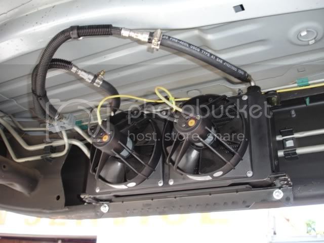

A cooler set up like this?

What are the specs on that cooler, nachos?
trying to find that out.
they are used for dmaxes and added to or replacing their stock cooler. the fan is hooked to a remote switch that you manually turn on/off.
after speaking with the guy he said that he recommends it being on the return line. the drop in temp from stock, on a dmax, has been 10-20. the cooler and fans come with instructions for installation. i just have to find space to put it now that the airdog is it the place i would put it.
what is the size of the fuel return?

1/2 once its on thw frame rail... Also you can buy coolers like that with fans from.aummit... Honestlt way overkill

id rather have way overkill then not enough, peace of mind for me.
im looking for an efficient way to cool down the fuel in my truck. ive had the fuel pretty hot where it feels like it loses power...not an option when towing and having big tires.
i also have an airdog so the lines on the frame rail arent any good
