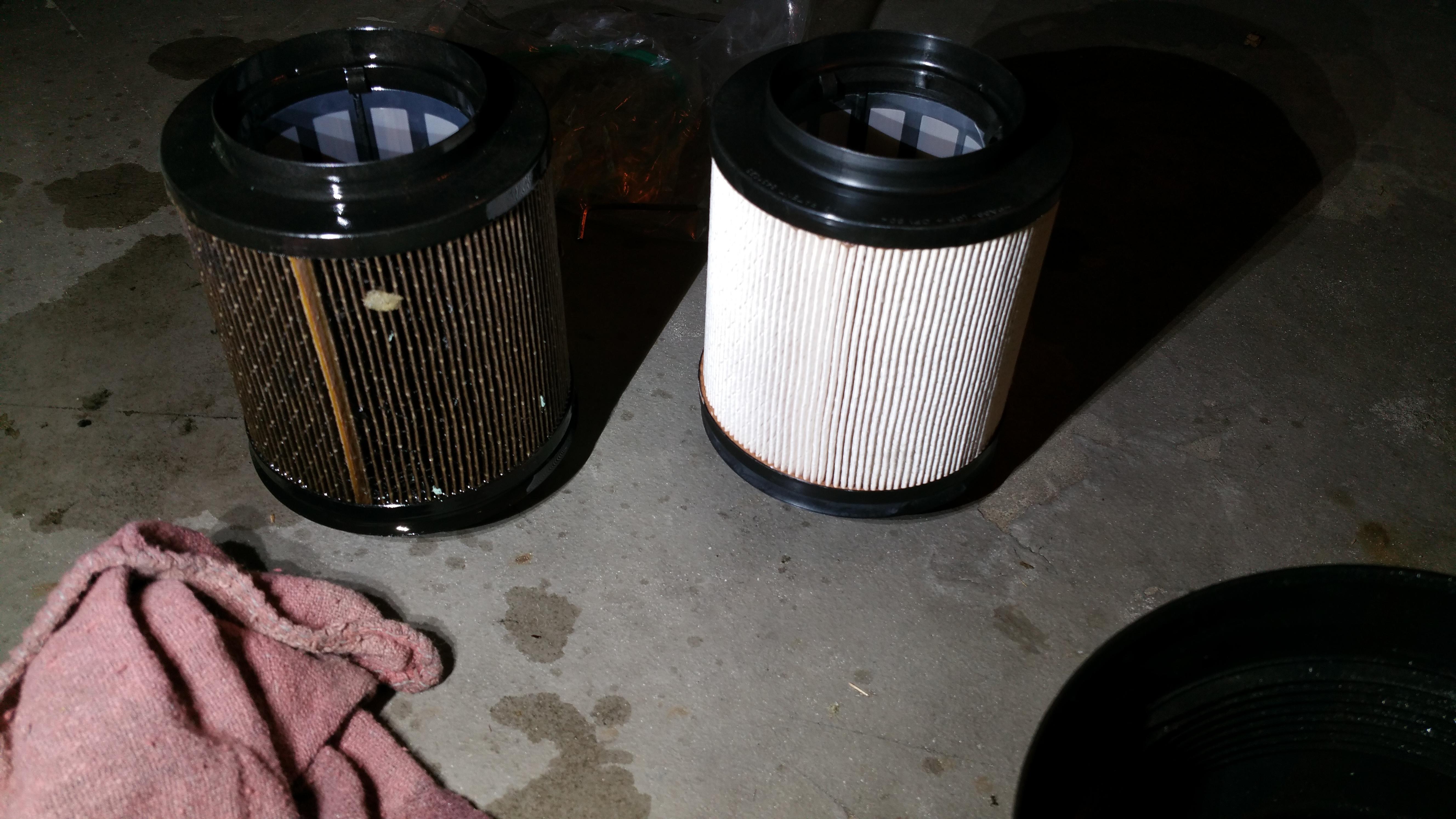

BIG JUICE
Jun 5, 2013
780
Valrico FLA
Dang. I was shooting for 20k. Guess I'm a bit on the optimistic side. Been a bit afraid of the breakage and noise stories.
I just changed mine, went 19k miles. I'll be doing th em sooner from now on.

JRLott
Feb 28, 2015
1,456
4
TX
You're killin me...now I simply must them this weekend. Getting near 18k. After reading here and seeing pictures, I was way the **** optimistic. Much grass.
