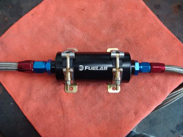

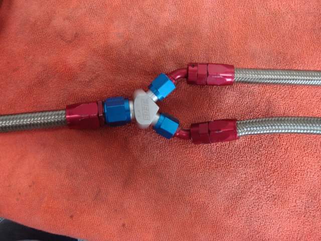

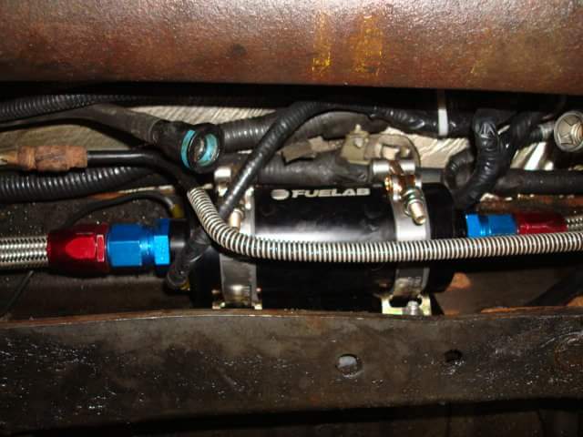

Ive been running a fuelab since 2009....zero issues and I love it. I have a low pressure FASS feeding it. Gotta run it on low speed. To do that you just gotta swap a wire on the pump to a different terminal. Fuelab has very little issues with their pumps. Lately for the past year or more...aeromotive has been absolutely terrible...guys going through 2 or 3 pumps in less than 5k miles.
strokin6L
2,979
Springville NY
Here's some pics of my setup. Sump going to low pressure FASS(water separator and 3 micron filter), then to the Fuelab. Out of the fuelab fuel goes to a y-block then two -6(3/8") lines feed each head.
