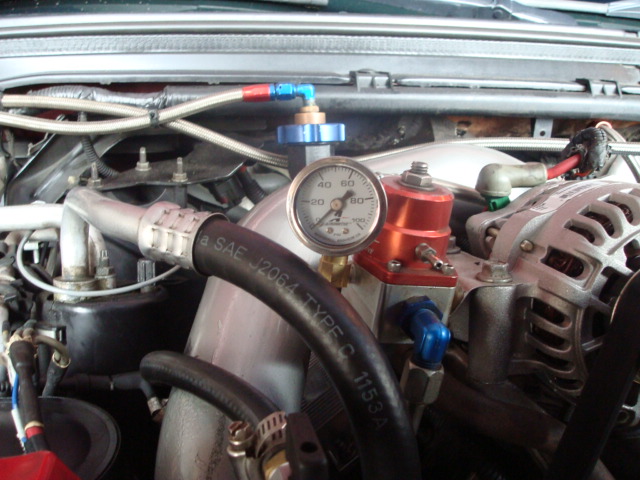

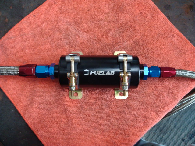

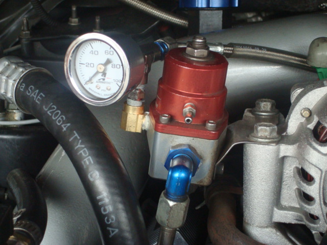

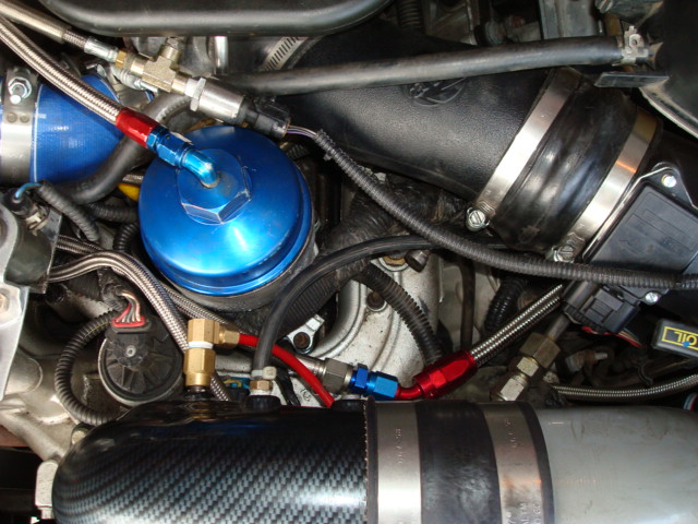

I love the idea of a low pressure pump system feeding a bigger pump, I have a low pressure FASS pump system feeding a fuelab pump. At first i ran the FASS feeding the stock pump(which is how it's recommended to be used) with 190's and had no issues what so ever. I made all my fuel lines...only thing left stock on my fuel system is the plastic tank. My system consists of a Hellmann's sump with a 5/8 line coming out and going into the FASS. Then a 5/8 line out of the FASS and into the fuelab pump, then 1/2 line out of fuelab and into a Y-block in the engine bay. Then 2 3/8 lines from Y-block straight to front of heads. Out of the back of the heads is where the RR takes over.
