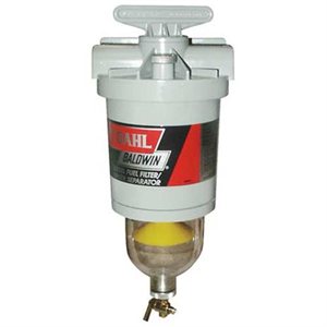

Has anyone tryed to get fuel water separator like this, and plumbed it before factory separator? uploadfromtaptalk1441464703557.jpg

Hi Dizzle, yes you can do that and a good separator on those trucks is a great idea as the factory's can send water with no light illuminating.
There are many set ups out there from building your own to $700 Dieselsite deal.
Napa has a wix book and it has lots of components for building your own, including a hand operated priming pump that can be incorporated. Most of the components will let you know that they are suitable upto a given horsepower range.
Another good option is finding nice used set ups off equipment. You can find great setups like ones made by Stanadyne .

i dont know why you couldn't plumb in a napa 3406 or a baldwin 1212 like we use on the 7.3s... its main goal is water separation. the stock filters are low enough micron to keep from trashing the fuel system but i believe the water separator is slightly lacking...
