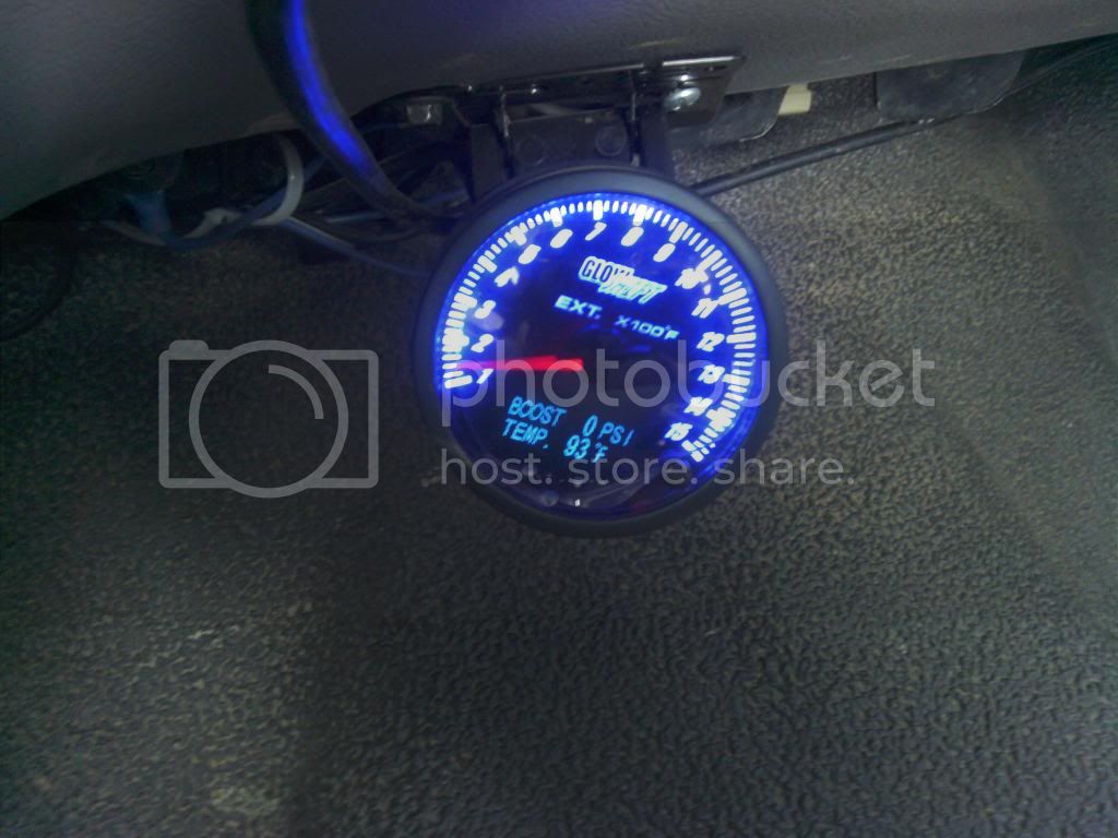

Gauges or at least an EGT gauge is 100% a must. These trucks will run HOT with just a tuner on them, and someone that doesnt understand not to lug them will cause the most damage.
This is true. I have my 6 pos chip in my 350 tuned for pulling and I can hit 1200* easy pulling a heavy load or with a light load and a head wind. I put a 3 in 1 Glowshift gauge in my 350 to try and keep the stock look and am pretty happy with it.
YJSONLY
May 19, 2013
42
Pics or link?
Redpower
May 24, 2011
308
Central Iowa
Here are 2 quick phone pics.
