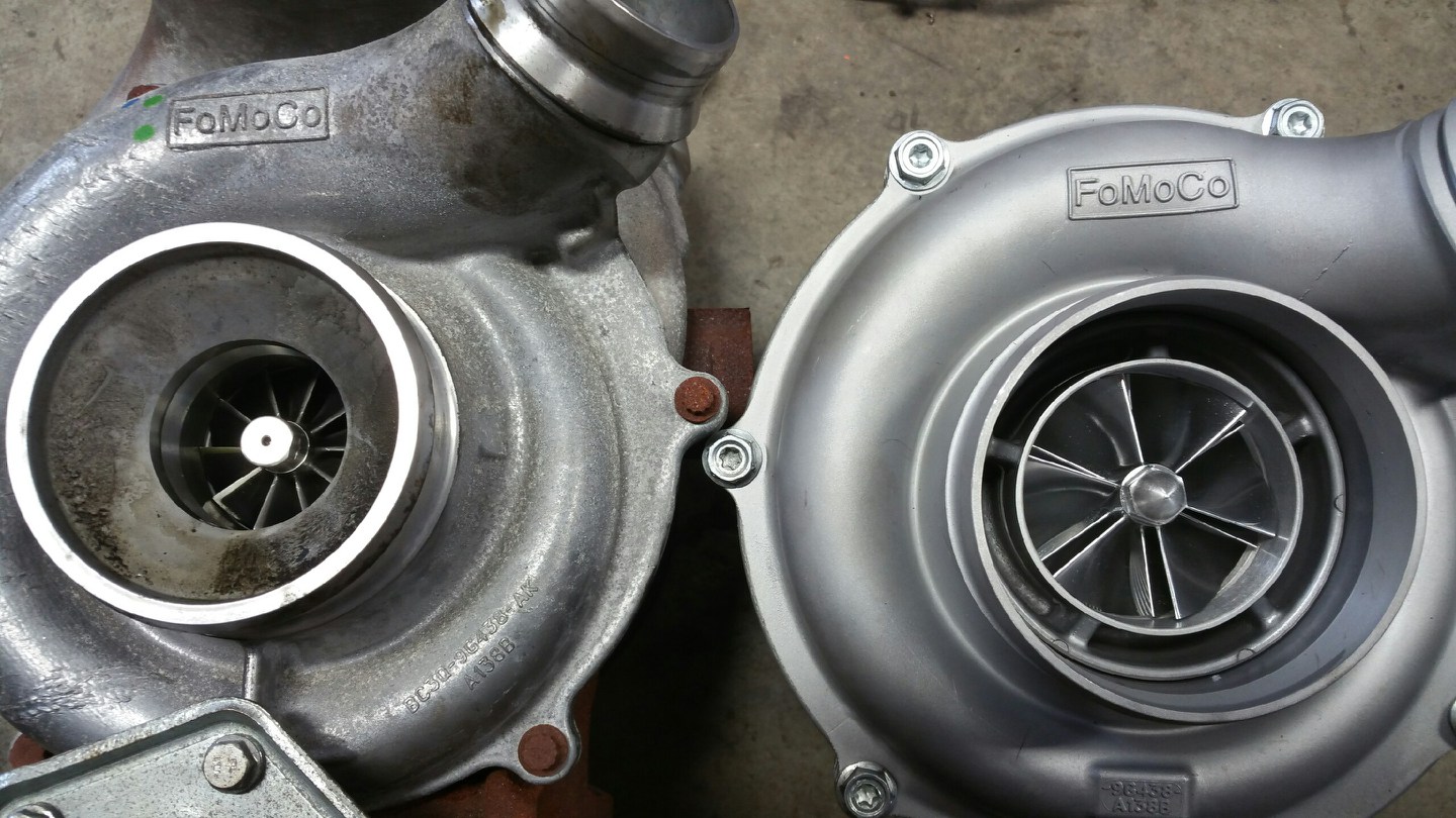

Getting the new streetmaxr installed this week

so is the new 65 or whatever? I'm jelly if it is. You will be super happy I have been running Morgan's 64MM for about a year and have nothing but good to say about it.

I ran for about 6 months without fuel upgrades. No need for more fuel although it does well with more fuel as well.
how much more power can you get with this turbo?
That's debatable. At my altitude 22 psi from the stock turbo is all you want to push, which is 425 hp on the dyno. With just the turbo upgrade my truck did 575hp and then with fuel mods did 629 hp.
