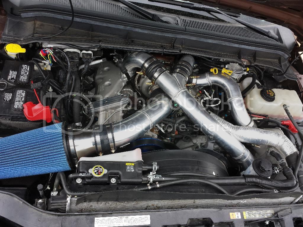

It's alive :joy:
Runs much better than my compounded 6.0.
More updates and pics tomorrow.

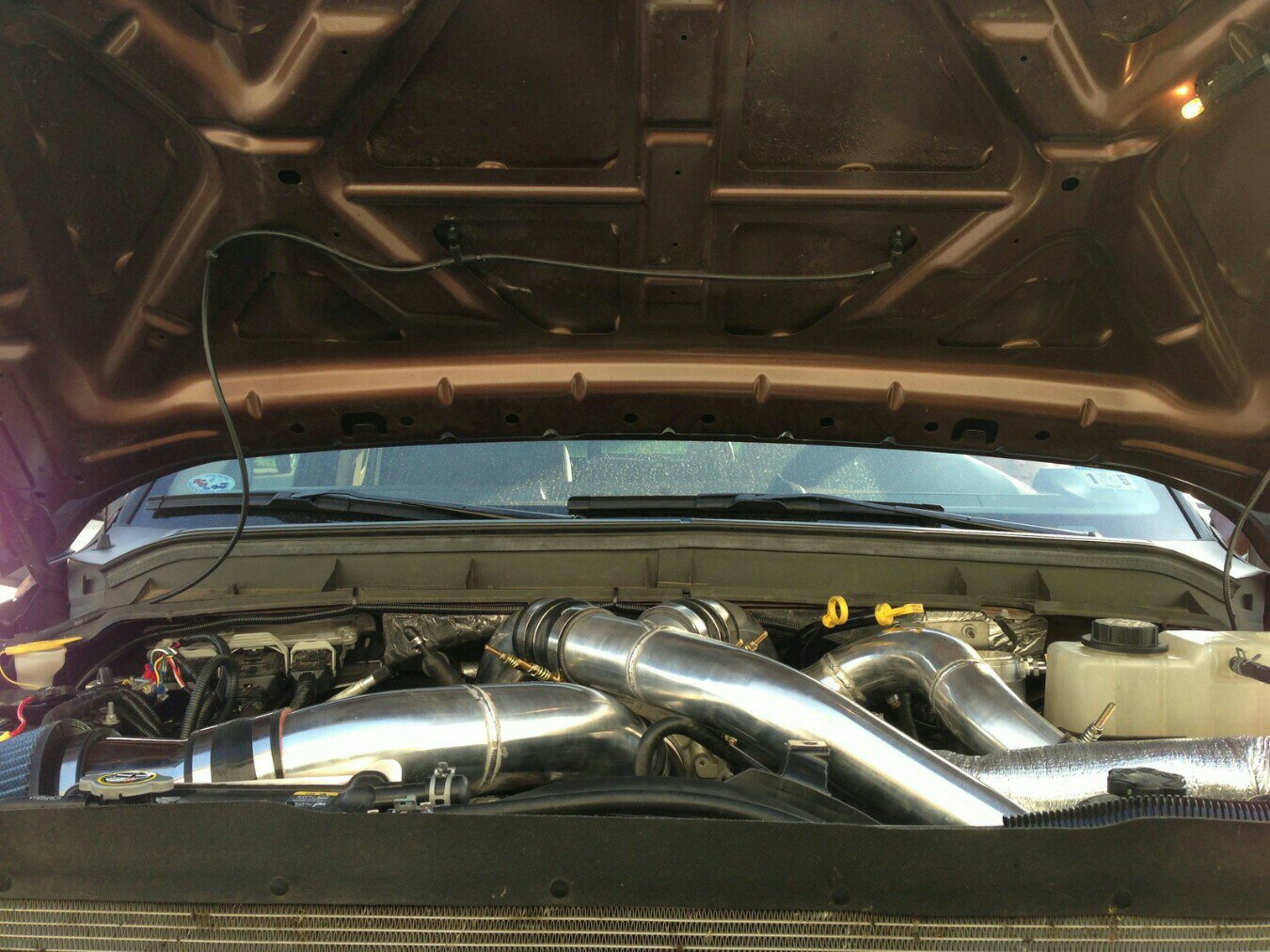

Elite VGT 6.7: https://youtu.be/GojfwEcZ1Zc
Not much left to do in the engine bay. Coolant reroute hose when Steves EGR delete arrives and hit the pipes with a cotton buffing wheel.
Here's a video on calibration 3 that I sent Gary. 3/4 throttle after 20mph. Didnt want to just step on it and throw a bunch of torque at the motor. No mcc unlock yet.
Sent from my SAMSUNG-SGH-I337 using Tapatalk
MorganY
Oct 3, 2011
2,950
college station, tx
Ugh. Is the kit as straightforward as it looks? That's gnarly. Looks like it'd be plenty rowdy once MCC tuned...
It's on the street setting on Calibration 3. Once Gary comes down, he can hit it hard with Tadd/Matt's MCC. I won't have the go pros strapped up until then unless I'm given permission to do otherwise. Boost is only about 25-30psi on that run; that charger is still healthy in the 40psi area. There is plenty of fuel to do so too.
The kit is straightforward. The cold side pipe took a hot minute because of its size, but Nathaniel made it a 3 piece pipe to eliminate possible vibrations.
