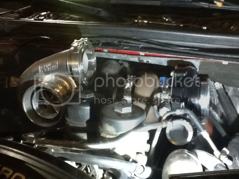

Going to try this out.
Jonnydime
Jun 26, 2012
2,322
8
Mike D's 82mm Max Power Atmo with a Gt4088R high pressure. I modifed Elite's vgt adapter. The fuel bowl will be deleted since I'm going to run Midwest's duel fueler setup with 60% nozzles. I will update as I progress.

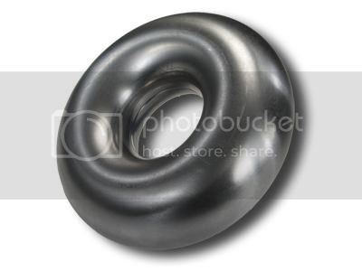

Does anyone know where I can get a tighter radius u-bend then the one vibrant offers? I'm running into issues fabbing a intermediate pipe. After I cut the middle of the radius out the pipe just does not look right.

Turns out I don't need a u-bend to get the radius I need but instead I need a donut. But boy are they pricey.

Big thanks to Shane for pointing me to woolf aircraft. I have 2 tight radius 90's coming that should make my intermediate pipe look and flow much better. The best thing is the price was less then half of what a donut cost and I will not have the leftover as well.
