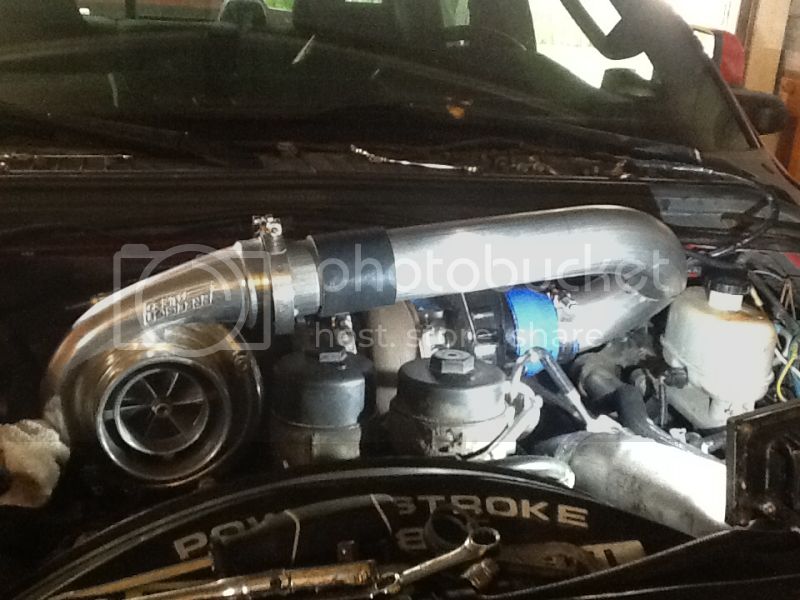

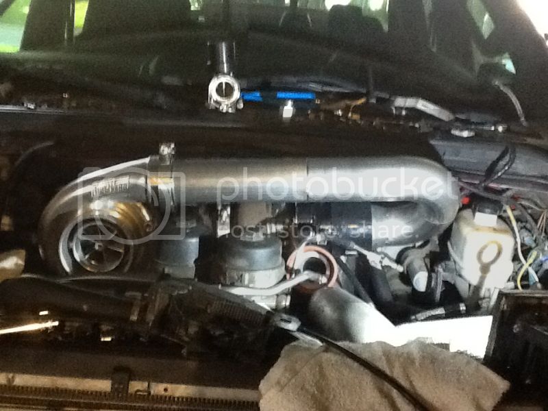

I'm still in the mock up fabrication stage of the build. Since I don't have access to a lift or a mock up engine to fab custom up pipes I had to modify a set of RCD 6.4 up pipes to fit the Garrett turbo. I just ordered two more bellows to fit the 50mm waste gate that feeds the 82mm and then I will be able to pull the up pipes and the rest of the top end apart. Doing all this work cab on has really tested my patience. I have found that beer and alcohol do wonders for raising my patience level. As far as the oil filter goes it will most likely be staying stock as I am more of a function over form type guy.

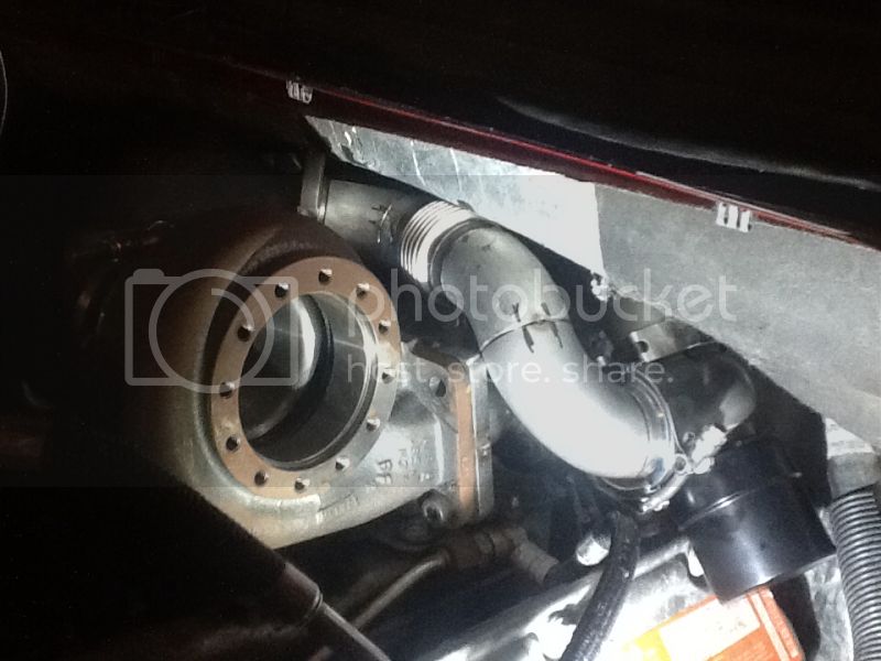

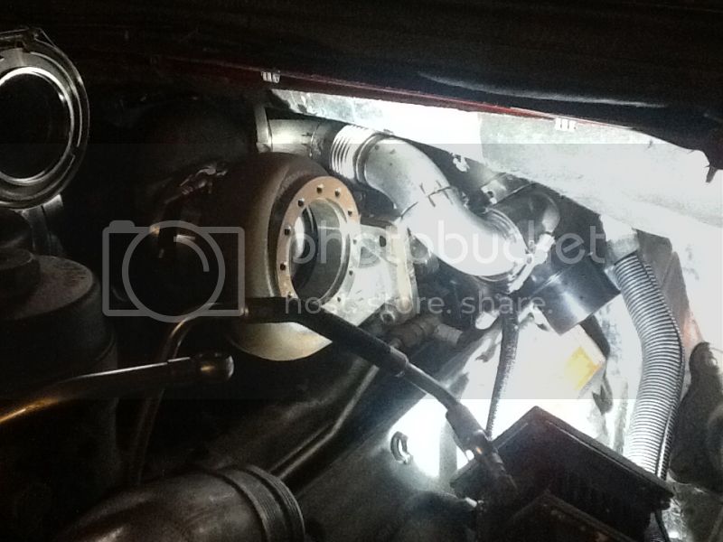

Wastegate

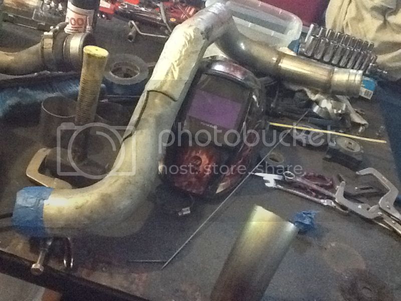

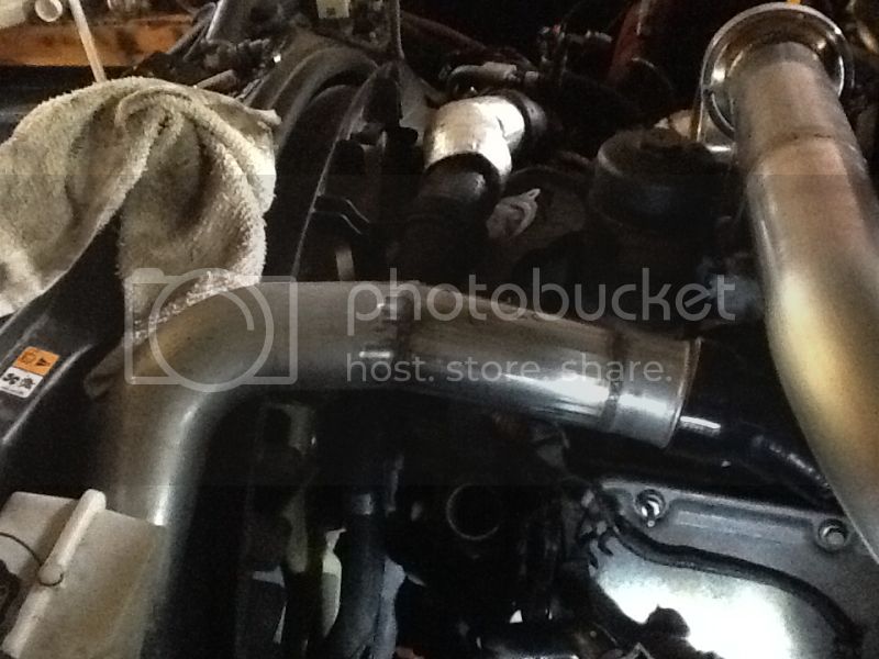

Tight radius 90's are much nicer. Thanks Shane (White_monster).
Vibrant's u-bend with a 5" radius and center cut.
Woolf aircraft products tight radius 90's which have a 3" radius. Much much better!!!
Jonnydime
Jun 26, 2012
2,319
8

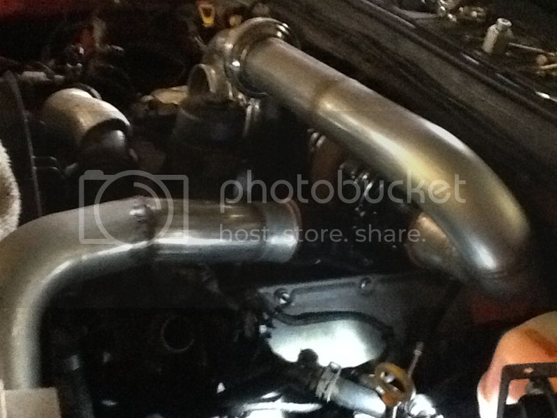

I modified the hot side pipe to work. I have a No Limit piece but I didn't want to hack up something so nice. So it will be for sale later.
