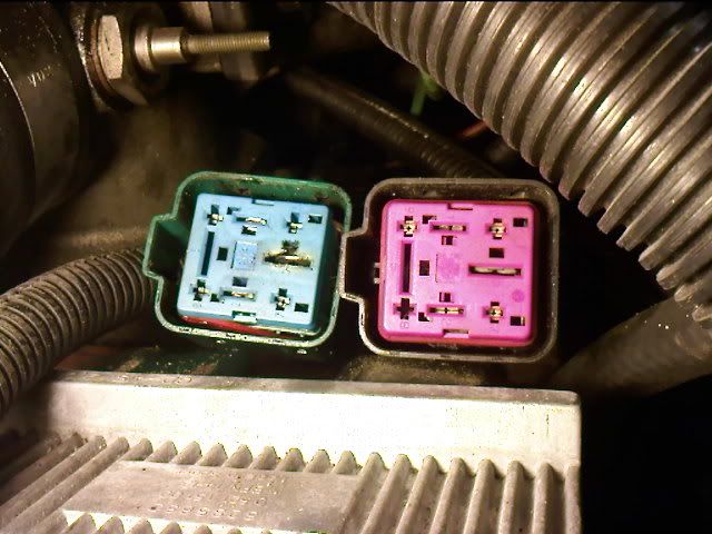

Unplug the harness(es) from the GPCM and inspect the pins on the harness-side. These can get messed up, usually from not being all the way plugged in and/or from getting wet. If any of the plastic looks melted around the pins - there is an Int'l part # for a 'repair kit' to replace the pigtails...
If pigtails look OK, ohm out the GP's thru the harness/pigtails right at the GPCM (this part is soooo much easier than the GP relay guys have it!) IIRC, anything under 2 ohms is a good GP.
If all the GP's are good, ya prolly need to replace the GPCM. I think I paid $130ish for my last one...
FWIW, I know my junk still starts OK down to about 40*F without GP's and to below freezing with only 1/2 of them working. :eek:
Here's a pic of a bad pigtail (blue) next to the 'repair' pigtail (pink):

Thank yall for the replies. So i went out last night and messed with it a little, the plug on the gpcm was loose so i took it off and cleaned it up. Went out this morning and she started up just fine... i appreciate the help, pics and all helped out greatly. Thanks again
