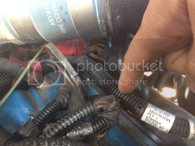

I bought a 2002 with no motor or engine compartment harness's and put a 99 motor in and got a 2002 compartment harness and a 2002 engine harness but the engine harness doesn't have a plug for the alternator ? Where does the plug for the alternator come from !! Thanks for any help..

I have an old harness that I could look at tomorrow but I would bet that if it isn't there then someone has cut it off. Have you tried removing the loom and looking for the cut wires?

This is where the alternator haress ties into the main harness on my '02.

Thanks 91turbogsx that helps a lot so it does come from the engine harness.. Mine doesn't have that and it doesnt look like it ever did but I thought it was suppose to be.. Thanks !

91Turbogsx can you give me the part number that is on the sticker next to that one its kinda cut off in the picture or can you get me the ford part number off the whole harness please time to start lookin for one.. Thanks

Ford number wasn't printed on the sticker but I got it for you.
This is the Ford number: F81Z-12B637-FA
The number listed on the sticker is the Navistar ID number. 1837761-C91
