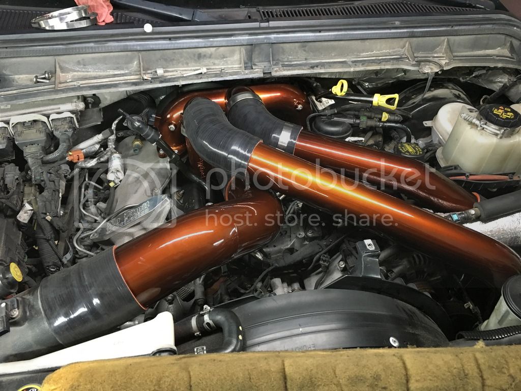

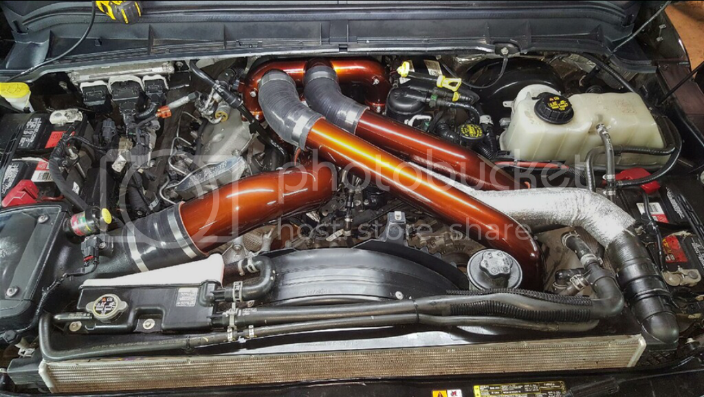

After endless research I chose the 66 SXE turbo kit. As anticipated the quality of the entire kit is incredible.
The turbo doesn't spool as quickly as the stock turbo did, as expected. When the turbo does spool and create boost it is amazing how hard the truck pulls. I was worried the NON VGT turbo would be to slow to spool, but its not a problem (for me) what so ever.
The turbo sounds very mean/tough with a slight whistle. It sounds nothing like the PIUS turbo option. I'm most happy to get rid of the infamous rick flair "wooooo". I will take a video in the next few days and post it for you guys.
I'm running stock fuel for now with plans to upgrade to dual fuelers in a few months. When I'm ready for another 100 horsepower I will be sure to let you guys know the difference. Even with Stock fuel the truck is fun as hell to drive.

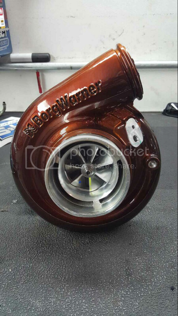

The color chosen for the turbo housing and piping is a dark copper. I love how it turned out.
Big thanks to everyone who answered my questions on other threads. Thanks to Dallas at H&S. Thanks to Tyler and the boys at TruckWurx for the attention to detail and great install.
