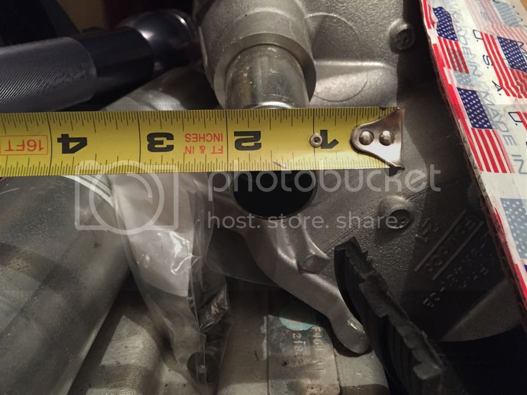

So I got the less expensive adapter kit but stupid me lost the rubber plug (my mind races 100mph and I do this a lot). Any alternative or replacement I can find? I messaged Dallas to see what he says.
Notneb
Jun 26, 2015
1,733
It's a 1" OD pipe, would hit up Lowes/Home Depot and see if they have any 1"ID caps.
nbh1226
May 14, 2015
40
I found the little stinkin cap! Got the hose off (luckily i had better access from EGR being gone). But that corrugated hose broke! In 2 places. Tape it together nicely with electrical tape and everything seems fine. Thank you!
