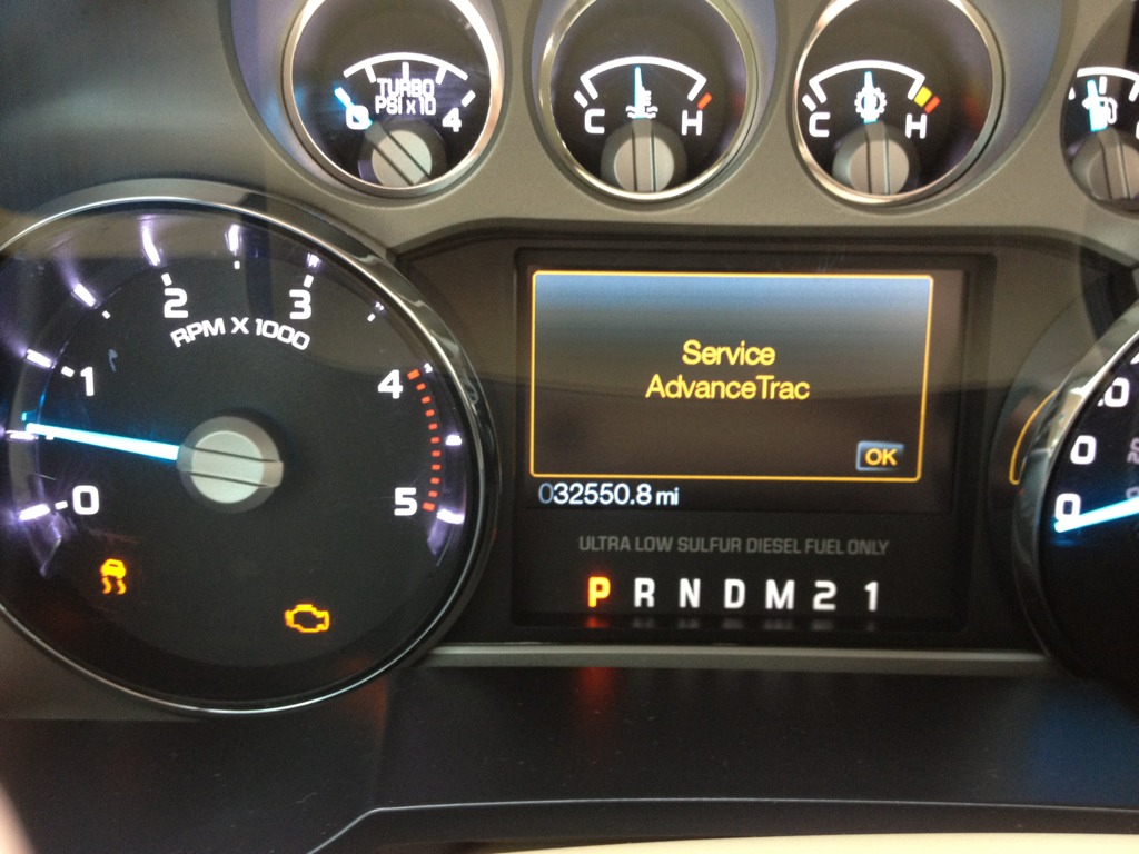

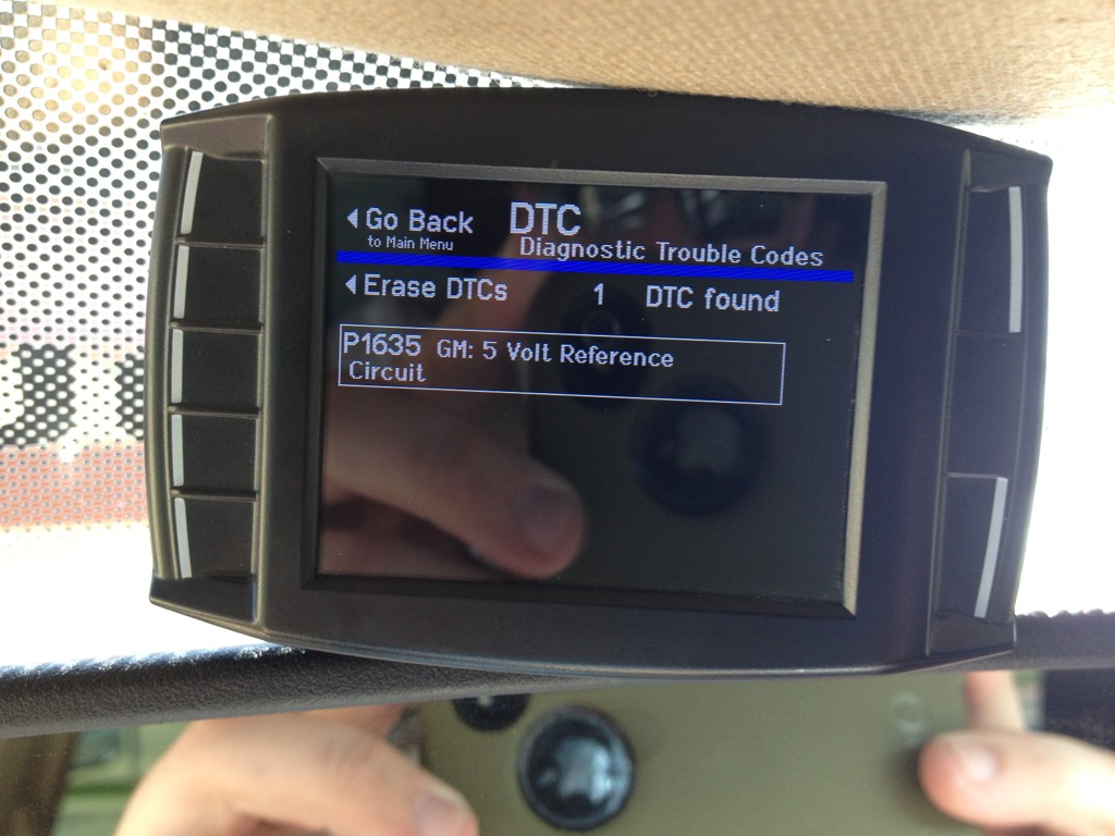

Set back to 32 as you explained to do
I get the service advance trac
And the check engine light is on and pulling codes from h&s say P1635 code

H&S Bentley
106
That code should eventually go away once tire size is back within specified range. There could be the possibility that the tire size message did not get accepted by the truck. The tire size adjustment is done in the ABS module. Try sending the signal again. IIRC, the stabilitrack message will go away immediately but the 1635 code will take a few drive cycles to heal itself.
Let us know how it goes. Thanks!
TXGLASSMAN
3,407
Keller Texas
Thanks Bentley that's exactly what happened it didn't accept it the 1st time reset it again and everything is back to normal
