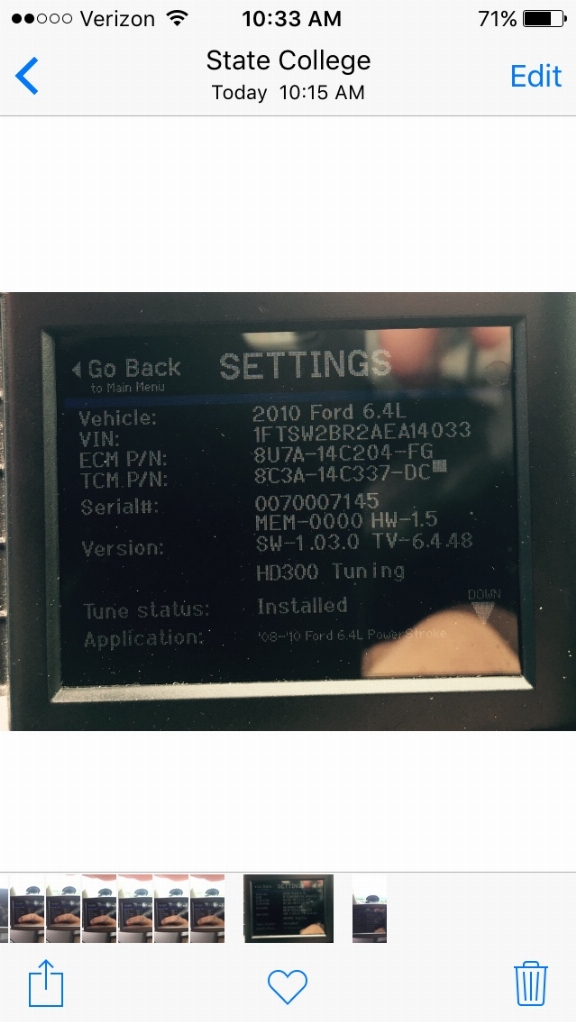

Awesome, this is the info I was looking for. So where would I find the version number? Owners manual, warranty card, or on the unit itself?
Another thing that may or may not help, my tunes are labeled: Stock, Tow, Street, and Performance. ? Does that help at all?

tap menu >show settings and the info will be there.

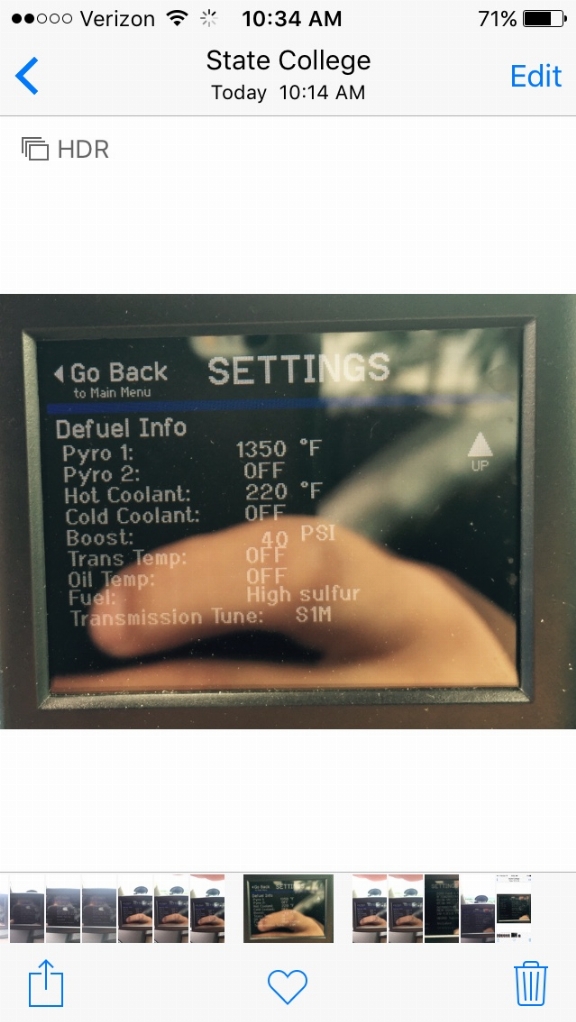

I just looked at the settings on my mini and we pretty much have them set the same.
You might have to reload the tunes and tell it *** ******d when you change exhaust. Its been awhile since I did any changes to it so not really sure. Since you already have the HD300 settings I believe you might just have to take pipe off and block egr(if you want, mini shuts it off).
