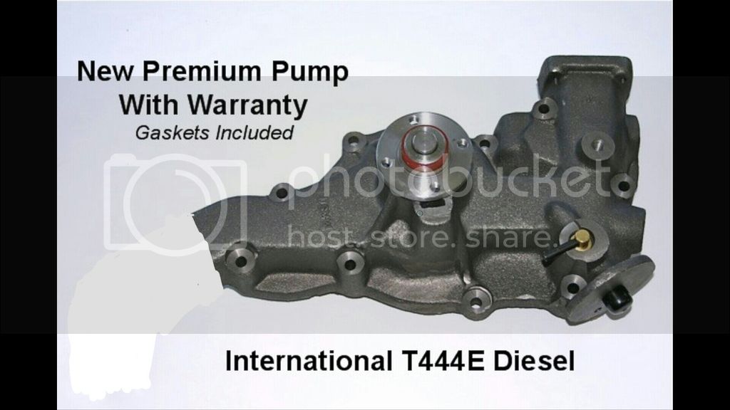

I think you'll get the idea. Cut that tail off, tap it for a male thread by 45° barbed hose adapter. Angle it forward and slightly down to get it out of the line of the pulleys and belts.

I like that idea though alot. Might do it anyways if I have some reason I am pulling apart the front. When you were looking at your dual alt setup did it look like it would take much more modding to get it to work with the t444e pump?

It'd work but the part i edited out is snack dab in the middle of the #2 alternator pulley. Up, down, left, right, in and out...its in the same spot. That tail goes away, is adapted to be shorter, angled at 45° forward and down, and you put a new hose on it. Done and done.
