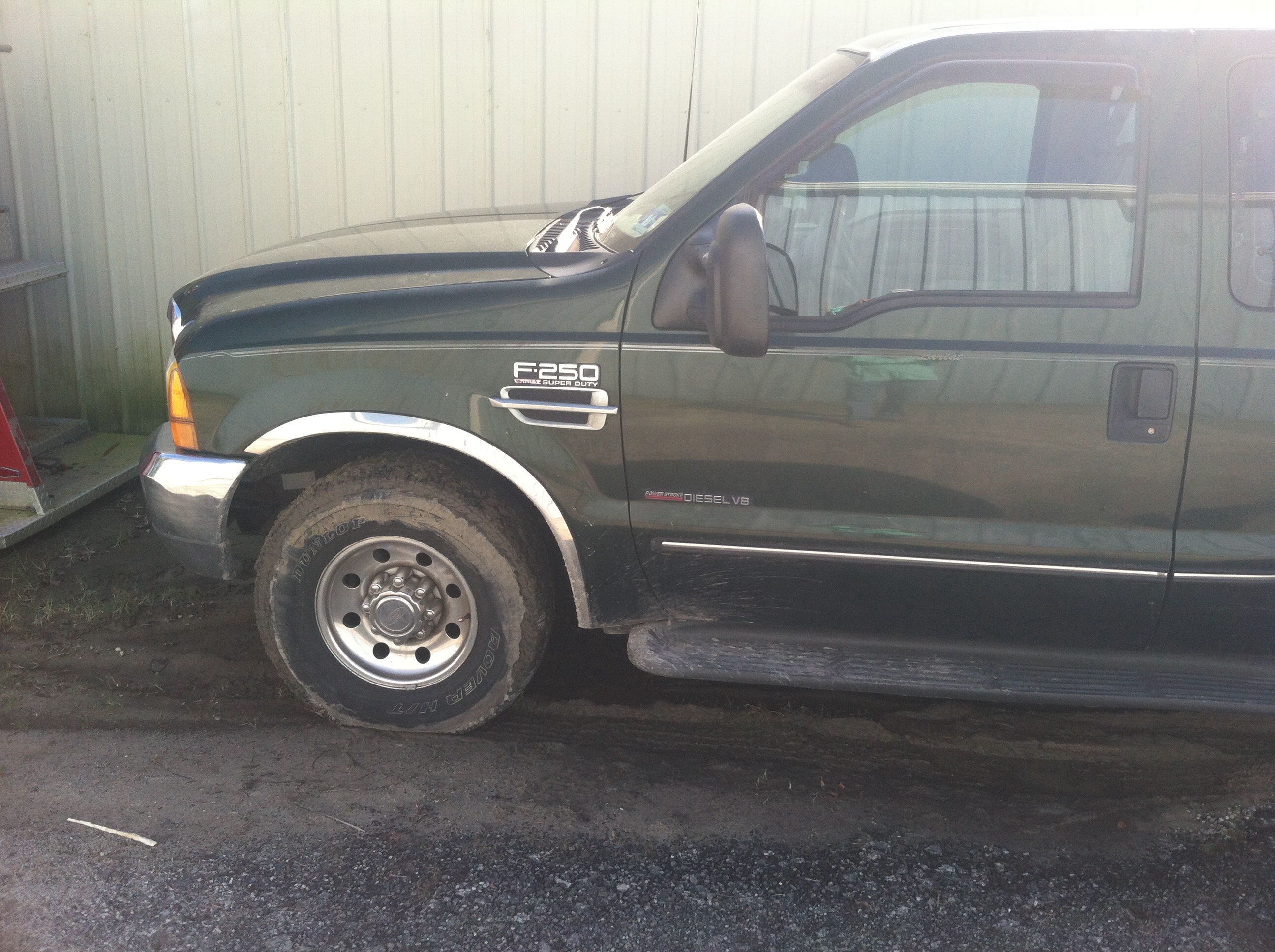

On step closer
Here's the truck I just bought to swap out engines. It's a 00 lariat. Just a little damage on drivers side. Actually drives pretty good and runs great. I started it up yesterday for the first time since the day beforeand only issue was a tiny bit of white smoke. I had a friend stand behind to look. It started easy and Jo rough running. I let it idle 10 min and drove it a few hard miles. No leaks except some oil in the valley. Transmission shifted just like stock. But no slipping and it had plenty of power. I'm going to drive it 275 miles home on Tuesday. 3k$!
