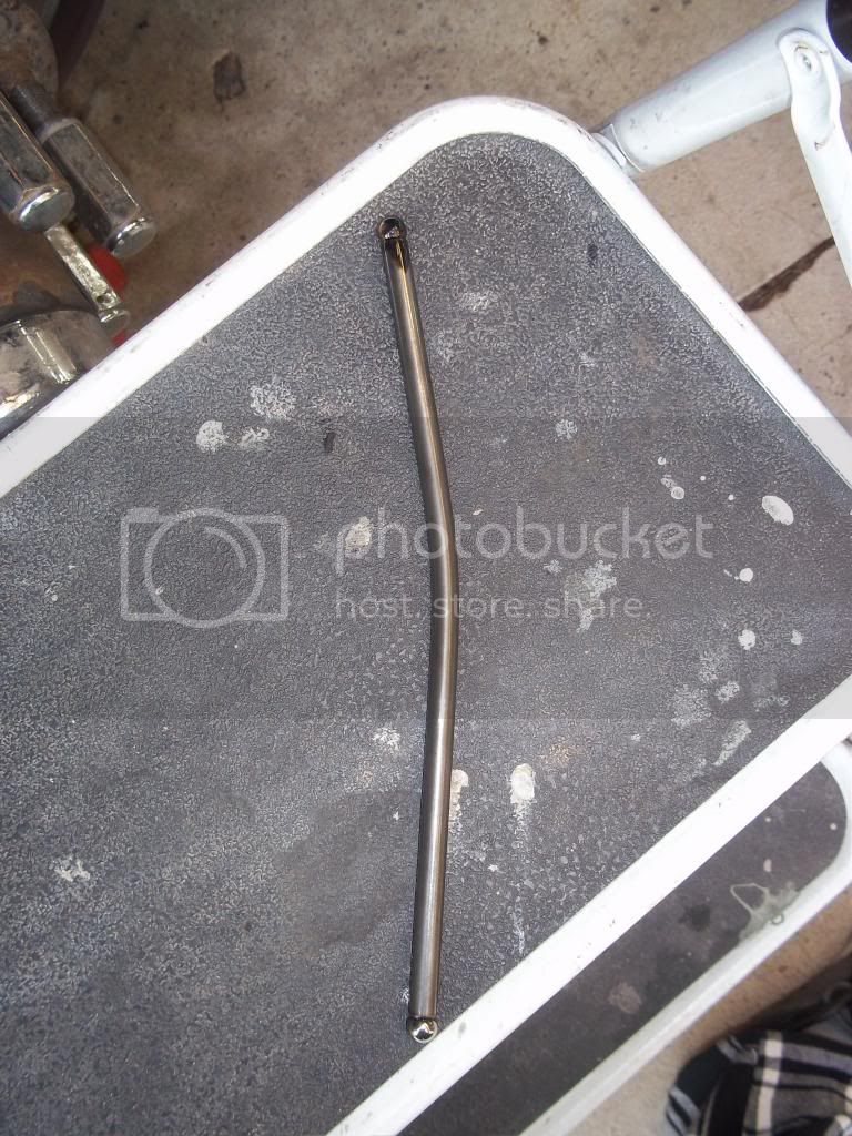

when i get stuff apart then i will know, he told me either bent intake valve or some rings in the motor? but more toward the intake valve

pretty sure i found the source, #7 on pass side

Make sure the cylinder is at bdc and tap the top of the valve with a mallet to se if it moves freeley. Did the new pushrod bend?
