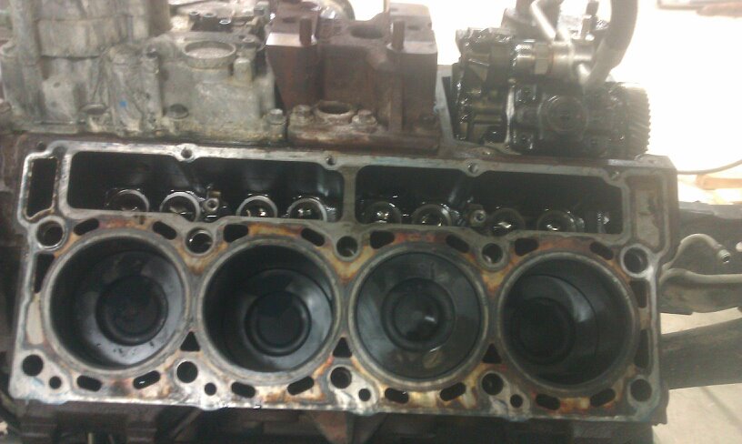

Well the heads are off. They are being sent out to be machined and fluxed. The guy doing the work said he took a good look at it and couldnt see any obvious cracks like the pictures online. ( good news for us guys with black trucks! :). ) He did say they were pretty warped, but nothing that a surfacing can't fix. He also said I will probably need a valve job due to pitting of the exhaust valves. He's going to look over the lifters and start working on pulling the cam today.

Few more quick pictures. Ordering a bunch more random seals and gaskets in the morning.
Has anyone on here besides RCD pulled the rear ring off the back of the motor and taken the cam out that way? Any problems after? The guy doing the work asked me if Ive read about any problems people have had on here from doing it like that. But obv there arent too many people with cams, or basic trucks with cams. A ford tech asked about the project when he was ordering stuff for me and told him never to do that. So hes going to call river city in the morning to talk to them some more. Im sure he can pick their brains way more than I can. Hes just worried about it being off balance and causing vibration or a couple thousand miles down the road killing bearings because its off balance. So after he talked to them I think we will decide the route he will go to pull the cam. He doesnt care either way, obviously not having to pull the crank saves some time and effort but thats not the important thing at this point.
