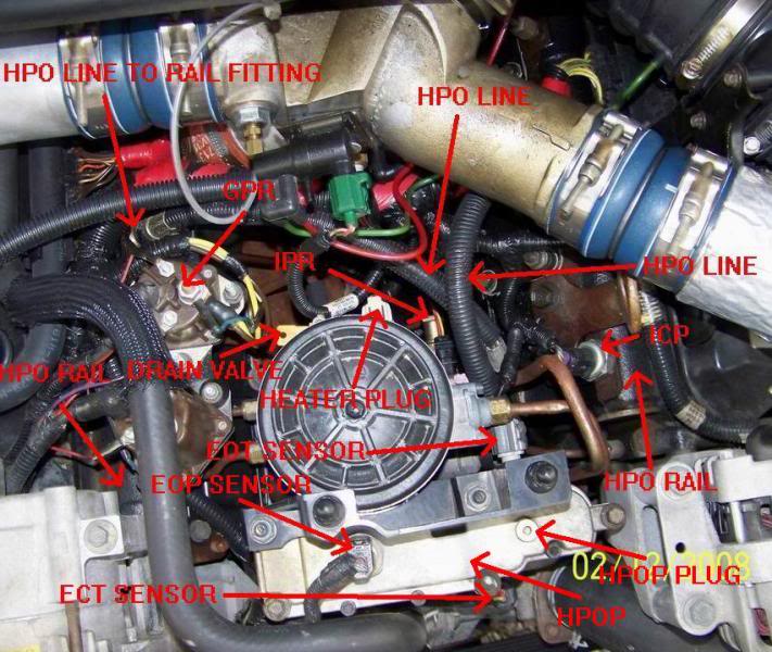

Don't need to wait until Monday.....go get a 5k psi mechanical hydraulic gauge and plumb it into one of the HPO ports on the head.
These motors need fuel and HPO (mininum 500 psi) to start. You already figured out that you have fuel pressure (well I think). Now find out if you have HPO.
Check the pigtail on the IPR valve for cracked insulation.

Any hydraulic shop. You'll need a length of hose with the fitting for the gauge on one end and I believe a 1/4" JIC fitting on the other.

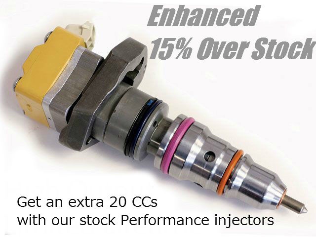

I think by the time it could get here I'll have something figured out, I appreciate it though! One more question. This may sound stupid, but where does fuel actually enter the injector for the injection process?

There is a fuel rail for all 4 on a head. There is access in the front and back with a 1/8" pipe threaded fittings.

It enters through the 4 holes between the pink and orange o-rings.
Hpo enters through the hole near the black o-ring.
