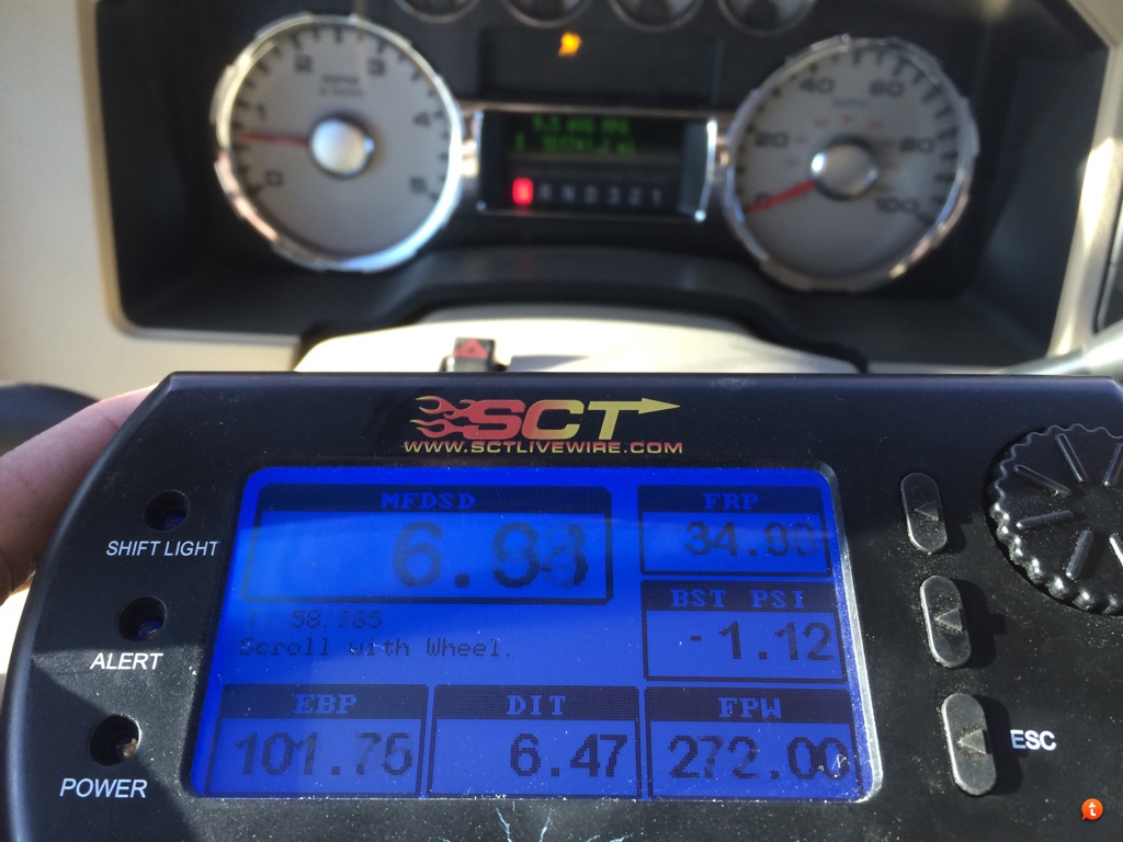

EBP reading like 100 at idle or so. Is that normal
Pretty sure ebp has a diffent form of measurement on the lw ,so it's totally different numbers. I wanna say it's kga or somehhinh weird like that , that needs a conversion table.
Dave
1,555
Yeah ebp reads weird on a livewire.
Sent from my SCH-I925 using Tapatalk
tbsimmons
Aug 5, 2011
2,221
Bakersfield, CA
I cant read it very well.
Lower left if MAP - 28 PSI Take 14-15 off and you should be in the 13 range for boost.
EBP - 40 PSI Seems normal. 12 higher than MAP.
What is the EBP reading with the truck idling? Should be in the 120 range on the Livewire
