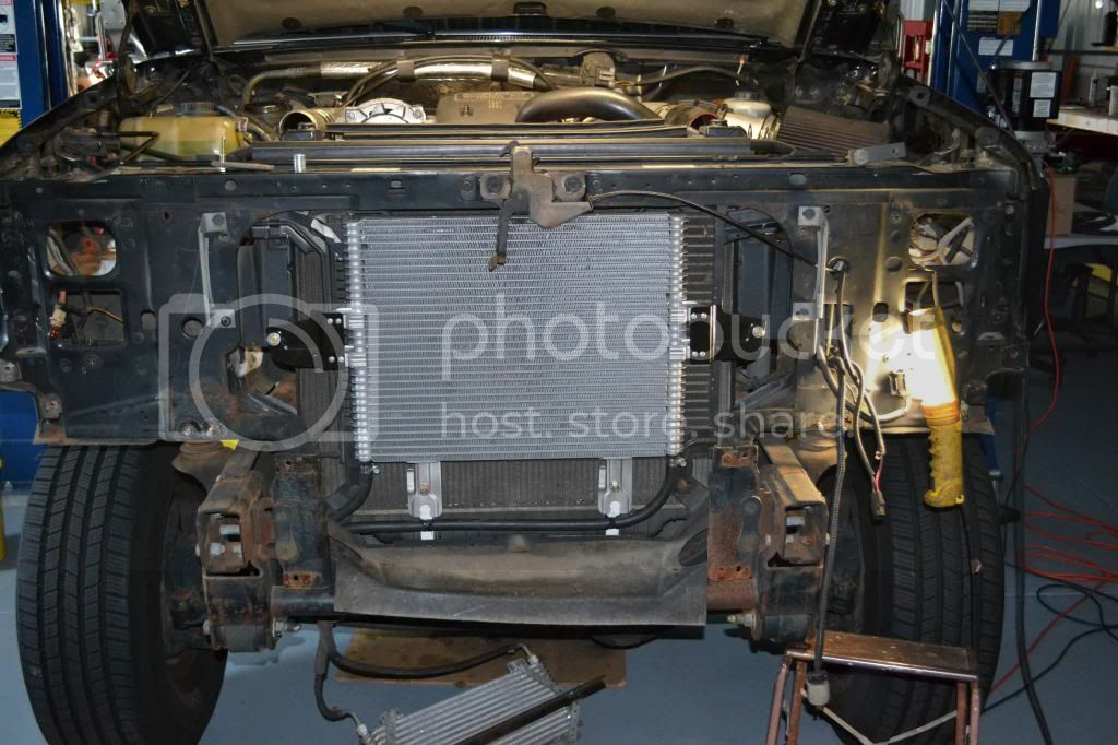

alradco
Jul 26, 2012
953
Does the routing of the trans fluid go from the trans to the external cooler then through the internal radiator cooler? My 00 does NOT have that. I want to add that into my truck and the radiator is a key ingredient, lol
No it goes to the radiator first then to the external. Previously I had just a large external and was fighting trans temps regularly. The external trans cooler would be so hot that you couldn't touch it. Now I can put my hand on the external trans cooler even after driving for hours.
Im not sure if you overlooked it or whatever but Peters truck is rockin a 6ish inch lift and 37s as well. So he is pretty high on the drag coefficient side of things.
Aerodynamics aren't exactly my strong point :D

Haha, the ic is badass but don't overlook the trans temp thanks to the radiator.
Yea I saw that too. I have a 6.0 trans cooler and switched over to SD trans cooler lines (5/16 vs 3/8) and I have similiar trans temps. The 6.0 cooler has 1/2" inlet/outlets.
Nothing against your rad, just not a fan of trans coolers inside a rad. Whenever a trans pukes, the trans coolers should be replaced which means the rad has to be replaced or cut open. I don't buy that they can get flushed out either.

TyCorr
Jun 23, 2011
15,461
Billy T.
gnxtc2@aol.com
Dont picture a cooler built for air to liquid and your mind should be at ease. Peter would have to confirm but the radiator cooler could be more appropriately described as a coil.
