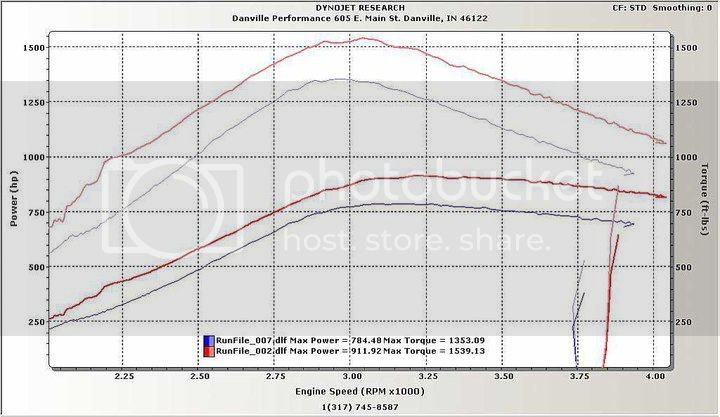

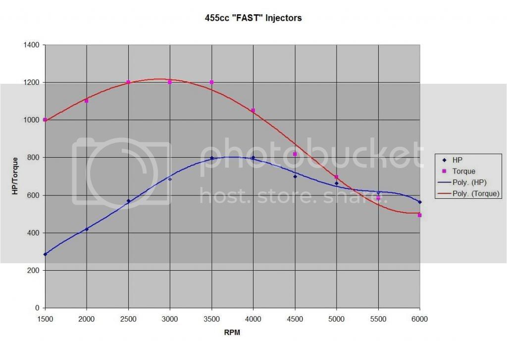

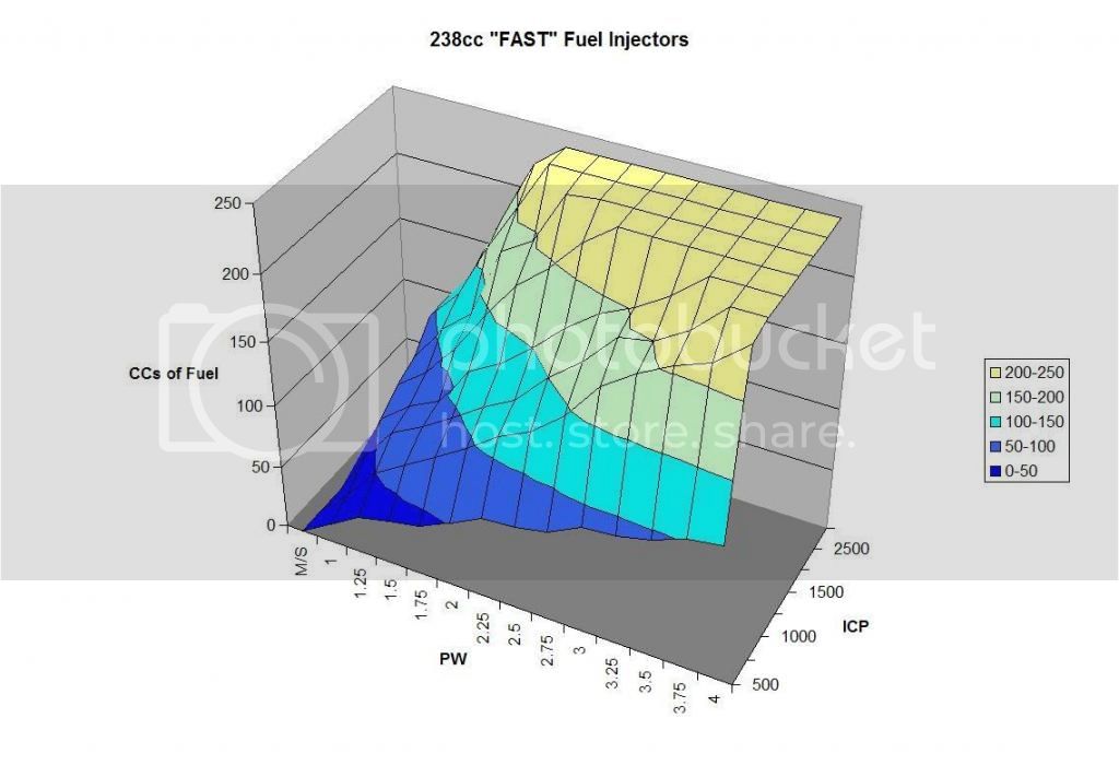

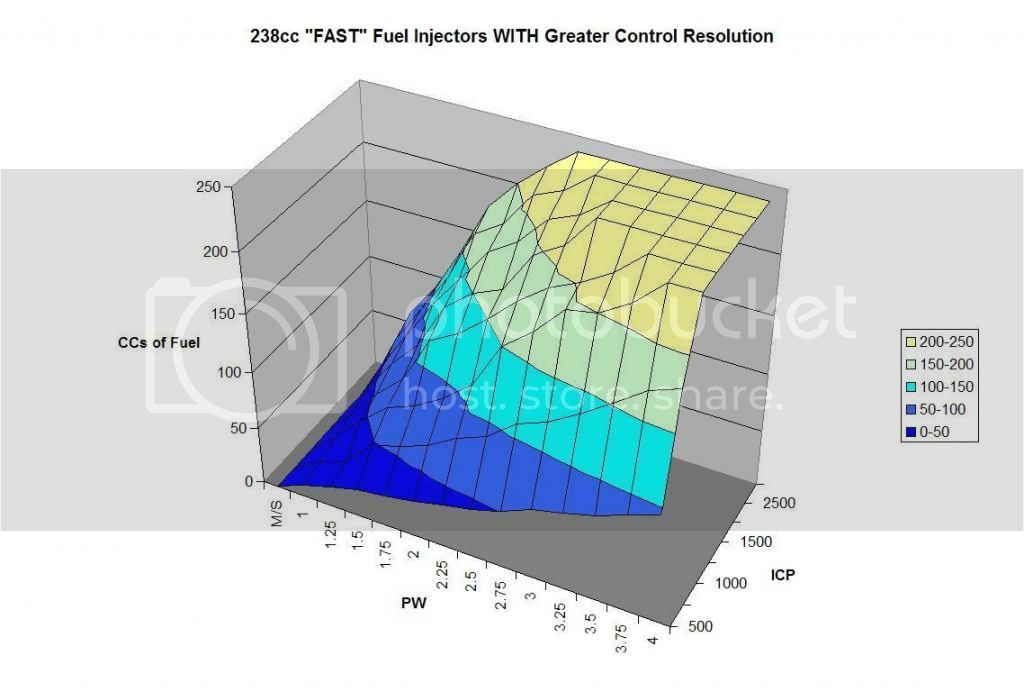

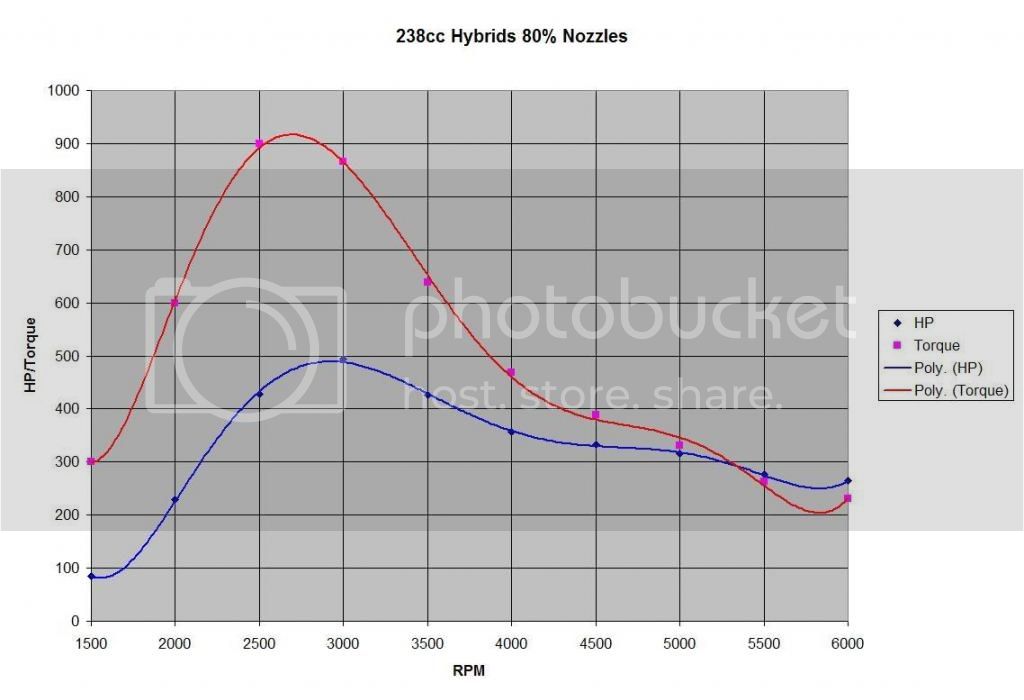

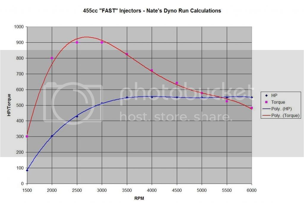

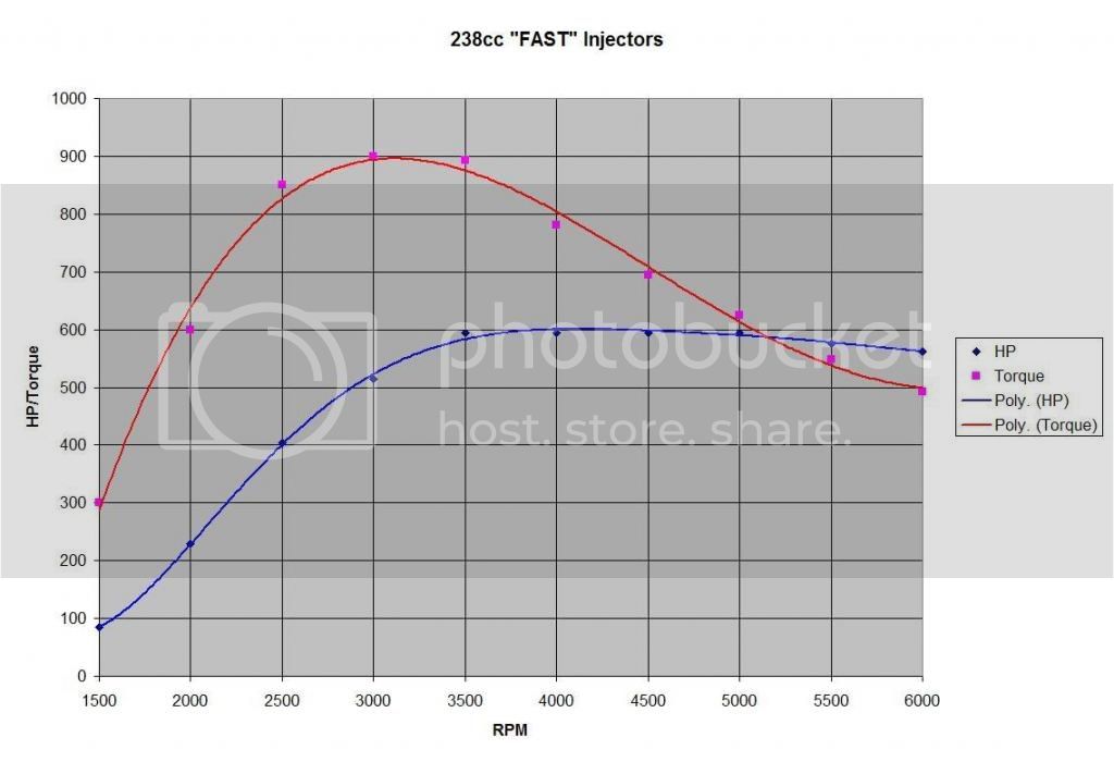

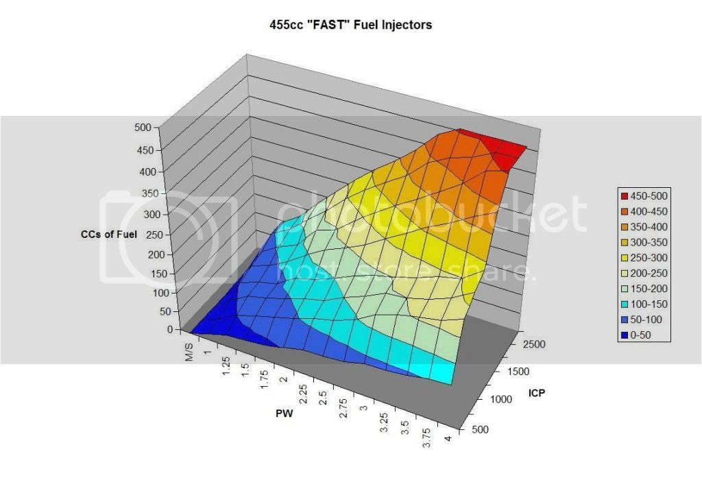

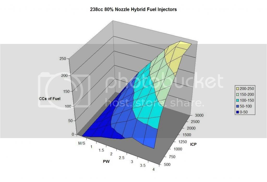

I hate Webshots.... all the pics of the graphs and **** are gone in the provided injector theory thread.... In no particular order here they are - I'll see if I can carve out some time to come back here later....
These graphs are all used in context of the earlier provided link.

so in essence, you can see what kinda power/curve/mpg/rpm an injector can make or be capable of with a graph? So is that to say that ANY 238/100 will look like that (as long as its from a well-known heui producer)? And ANY 455cc injector will flow/curve like that?
