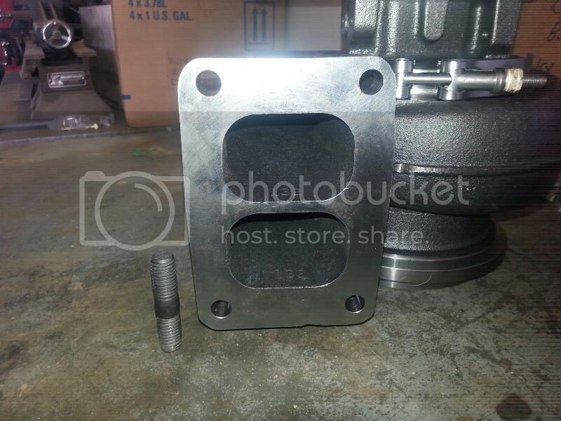

Somewhat urgent question. Doing the PDI exhaust manifold on the ISX with the BW turbo. The thread for the studs on the manifold are 1/2", the holes for the studs on the turbine housing are only 3/8".
Is there any reason I cant carefully drill the bolt holes out enough to work?
No one I've talked to or called have had this issue before. I can't forsee it weakening the flange, but I have been wrong once or twice before.

Go for it. I had to replace the charger on a tractor years ago and it was the same deal. Drilled it out slowly with plenty of cutting fluid and it's still running with zero issues.

Thanks for the input guys. I'll knock it out to the right size tomorrow. I couldn't see why it would be an issue, but enough of a rookie I felt I should ask.
Can't wait to see/hear the difference on this thing once I get it back together!
The other option is a stud with each diameter, might be tough to find though
The first thing I did was a quick call to Fastenal and Grainger and they said they had nothing in their books which was disappointing. I was hoping for a solution that quick and easy, lol.

I was thinking auto parts store hardware
It drilled easier than I thought it would so it was still quicker than running to town and hunting for the right parts. Cheaper too! lol

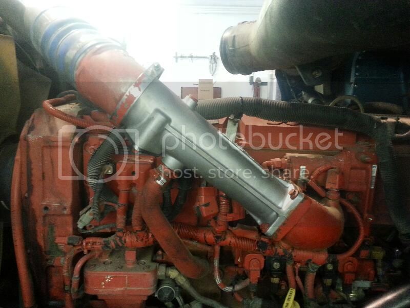

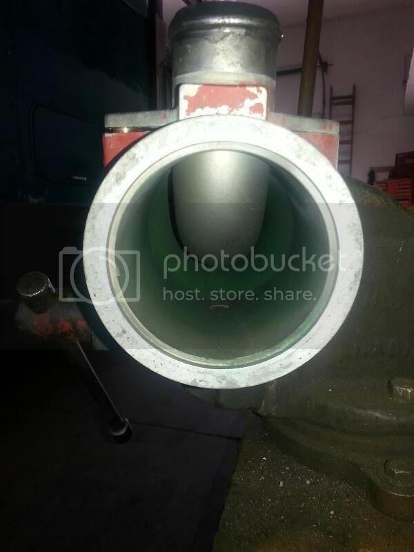

PDI intake manifold:
Stock intake that pipes down to 2" with this EGR neck in it. Which feeds a 15.0L engine... :bs:
