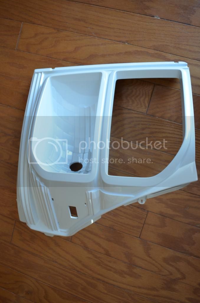

got the chrome off![]()
a box full of stuff from the retrofit source
i got some mini gatling gun shrouds when i ordered but they are too small ordered the 2.0's on b stock to give them a try
for those who posted how did you seal up the housing since your not using the h13 bulb anymore? can i get a visual
I took some of the clearance projectors, and separated the projector from the reflector housing, centered them the best I could and tapped some holes and mounted them with screws
cool. yea, i last minute decided to go with the quad projector look. I'm bummed i can't start fitting anything till next week my painter at the collision shop i have been using took a week off ..
I've got the xb's also and auto still works like factory I'm extremely pleased with morimoto! I ordered the 4500 lumens and light output is awesome! As far as reopening them if the paint messes up, just take it off with easy off oven cleaner, had an old body shop guy show me that trick to strip paint.yup yup just ordered a mini d2s 3.0 kit from TRS cant wait to get started. post all the tips you got lol! i got morimoto xb ballasts hope auto on still works.
1 quick question. im going to have to bake my already painted headlights to get them apart. any worries?
