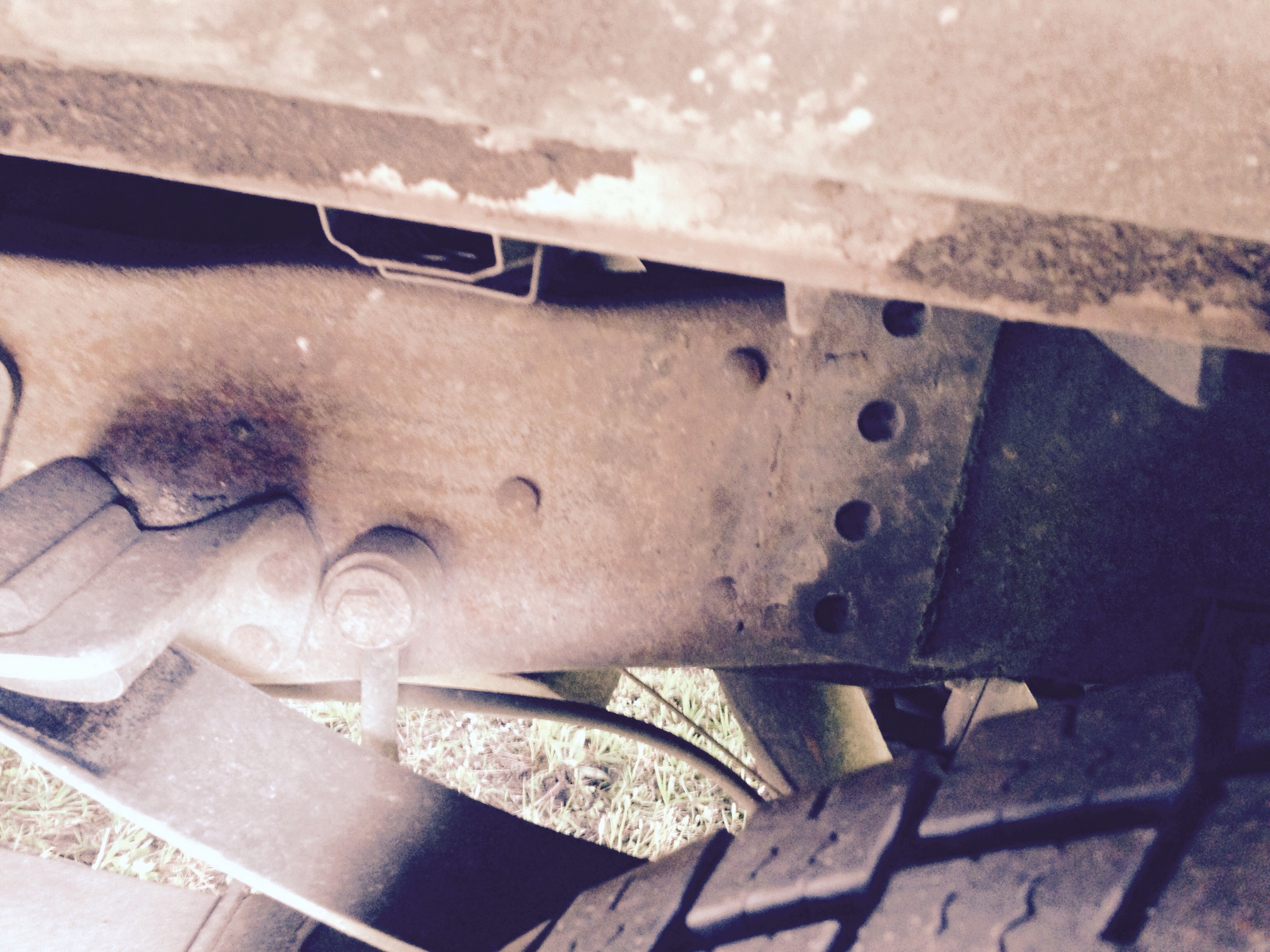

I've got a high jacker slider in my obs if you have the rails it should be some grade 8
1/2" hardware and some heavy duty angle brackets drilling holes and bolting in the driveway if you do not have the rails redneck trailer supply got my last set for like 200$
I'll be by my truck in a little bit and snap some pics and post them up

Bed rails
