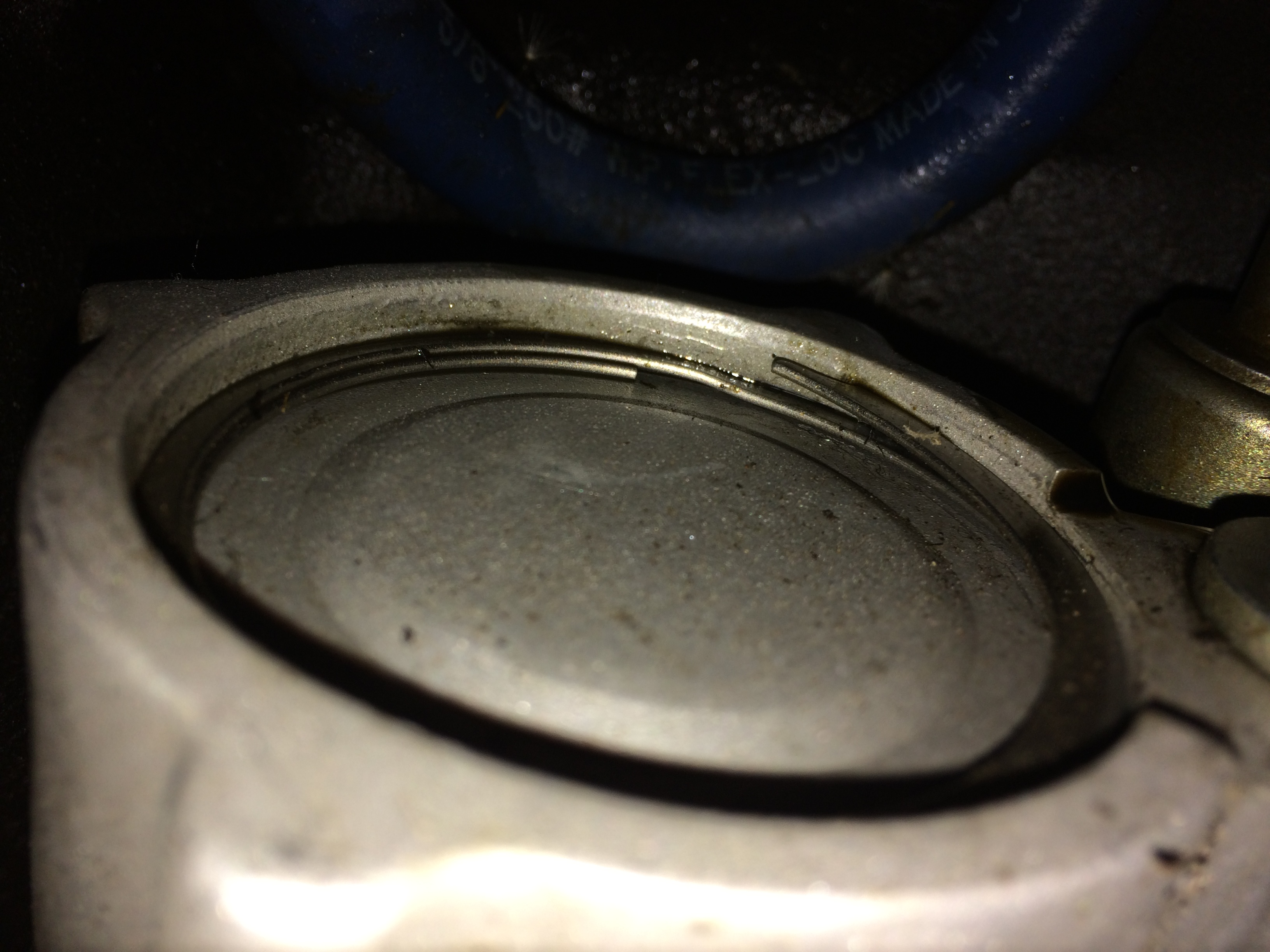

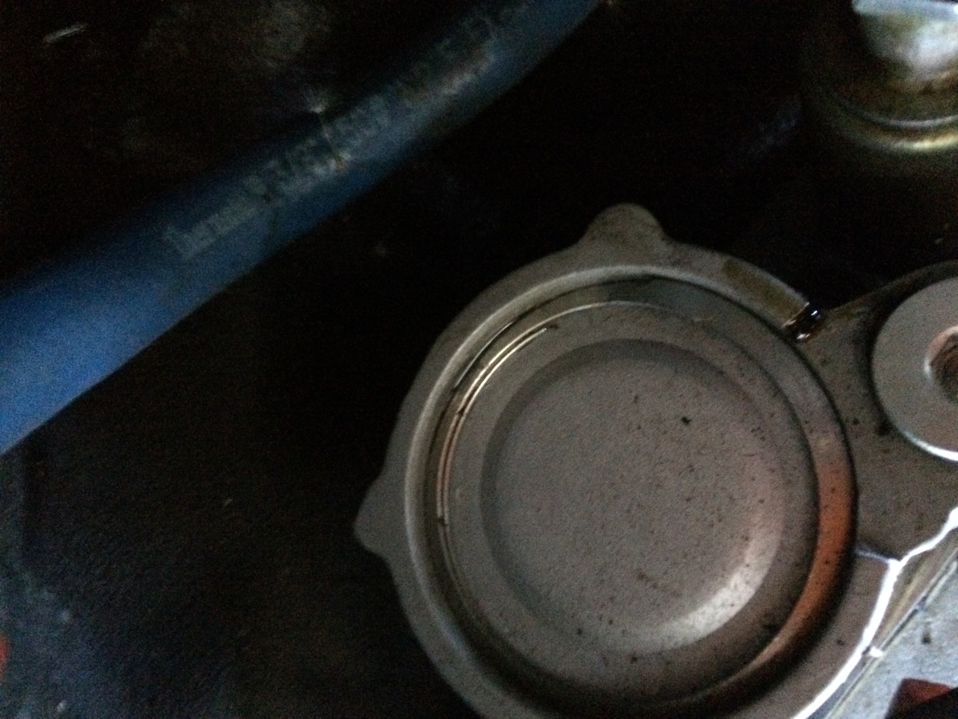

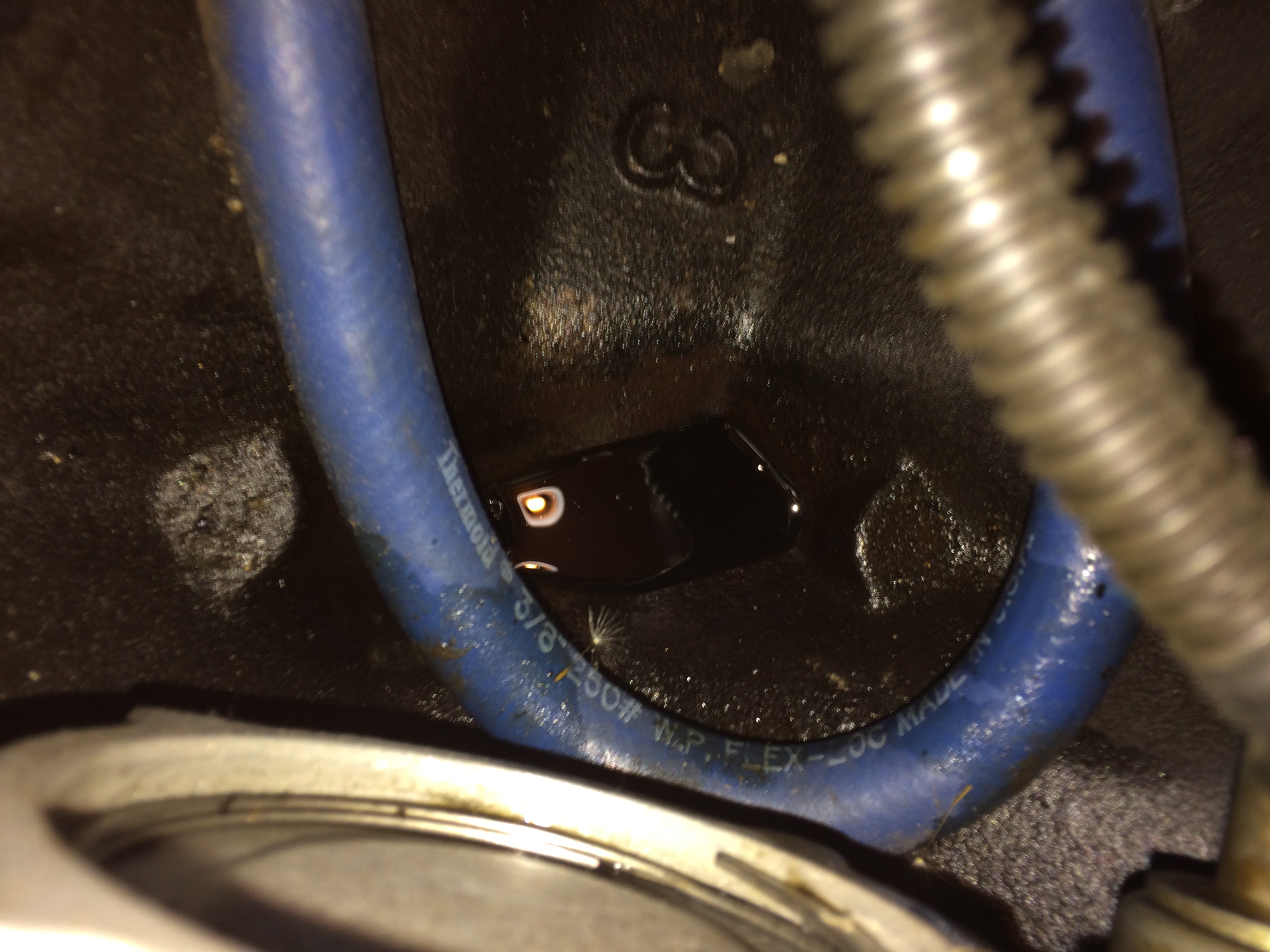

IMG_0309.JPGFigured I would post up some pictures of what my HB Jr. is doing.

Might be hard to see, but it started leaking oil and the snap ring is falling out of its grove. Would a seal kit from riff raff or someone be a better option to reseal the leak and use a different snap ring??
will the spiral ring go back in its groove? or is tge housing rounded off?

It might work better to replace that spiral ring with a real snap ring.
Whatever you do, don't do it with it in the truck. On a bench on a white towel.

I've put it back in the groove twice now and it still keeps piping out. I think I'm going to look for a snap ring that will fit. Plus I need to fix the oil leak on the bottom of the pump.
