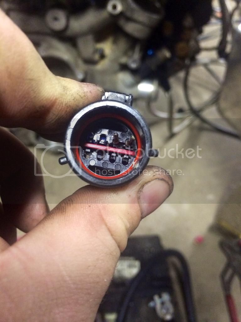

Remove the old harness and find the plug that looks like this.
I had already modified this one before I took this pic. But the green loop back is what you need to worry about. You have to change the pin out locations for the green wire and remove the others.
To do that you need to take and pull the rubber stop out so you can access the release pin.
I used a piece of 1/16" tungsten to push it out.
Once you have removed the red tab, proceed to remove the other wires and pins and put the two green pins in the location you see here, then button it back up and plug it into the factory harness along the fender well and you are DONE.
