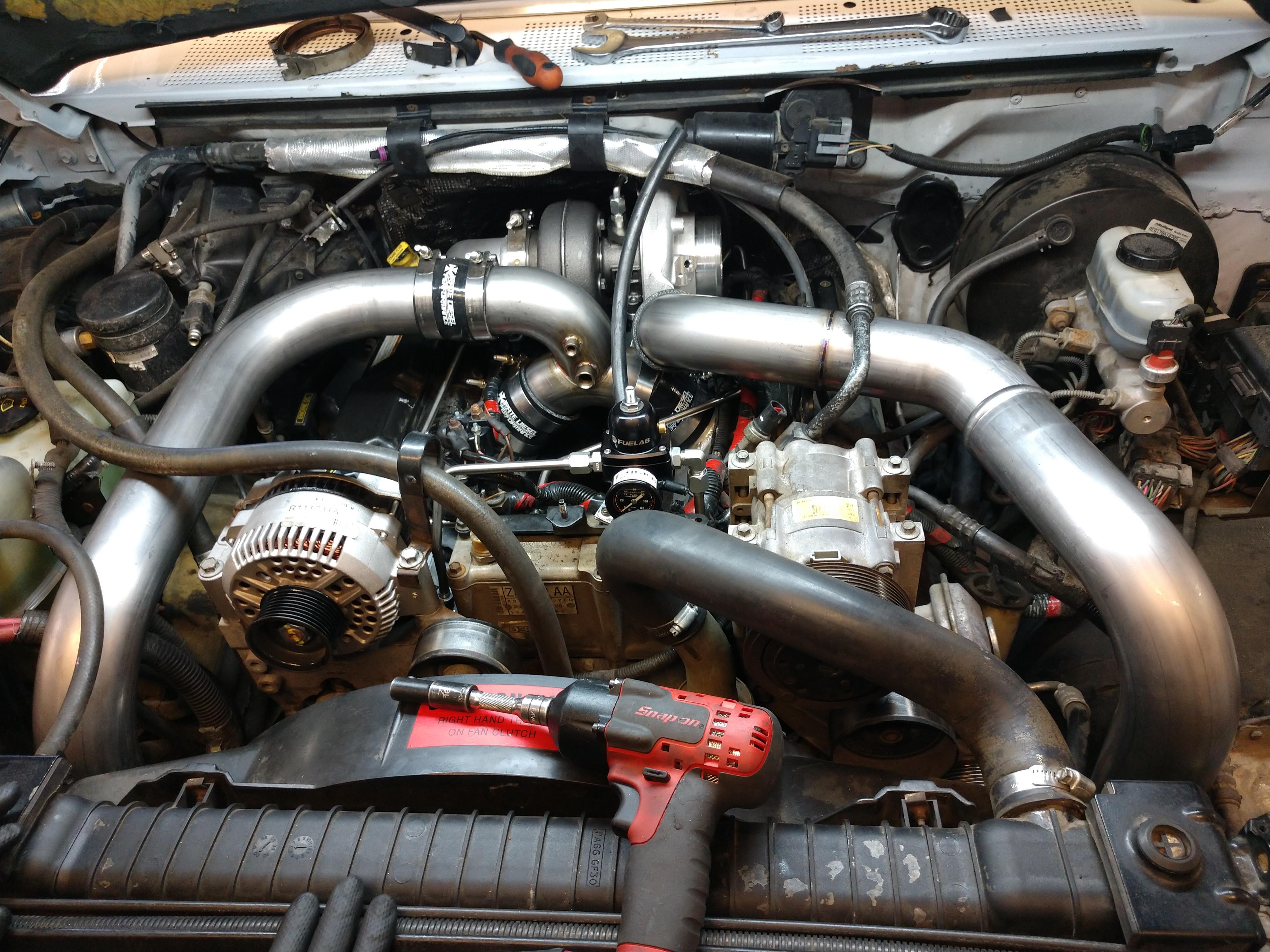

Stopped by the shop on the way to work this afternoon. Should be done tomorrow.

Picked the truck up today and drove it to work. Normal highway driving it seems to be 30-50 degrees cooler is all. Is this normal? I'd have thought it would be more?

Get a different tune. Sdk is a good tuner. That turbo should lower eggs by margins. Boost leak maybe?
I wouldnt expect to see much for egt drops when empty. Hook a trailer to it and that will show you the difference.
Also its never a bad idea to check for boost leaks. Anytime I pull my intake plumbing apart I check to make sure its all sealed up. Its amazing how often ill find a little leak here or there.
