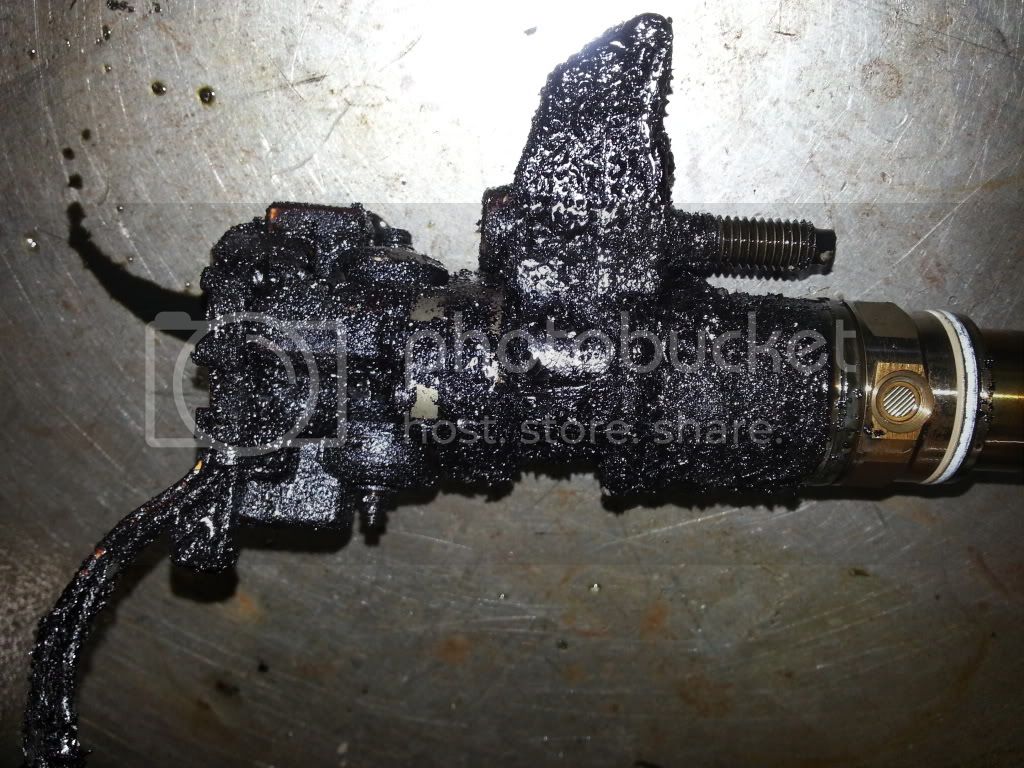

I'll get some picks of one that's worse than that I'm doing a motor swap on. It ran awesome too. Weird as hell that it did though given the condition.
