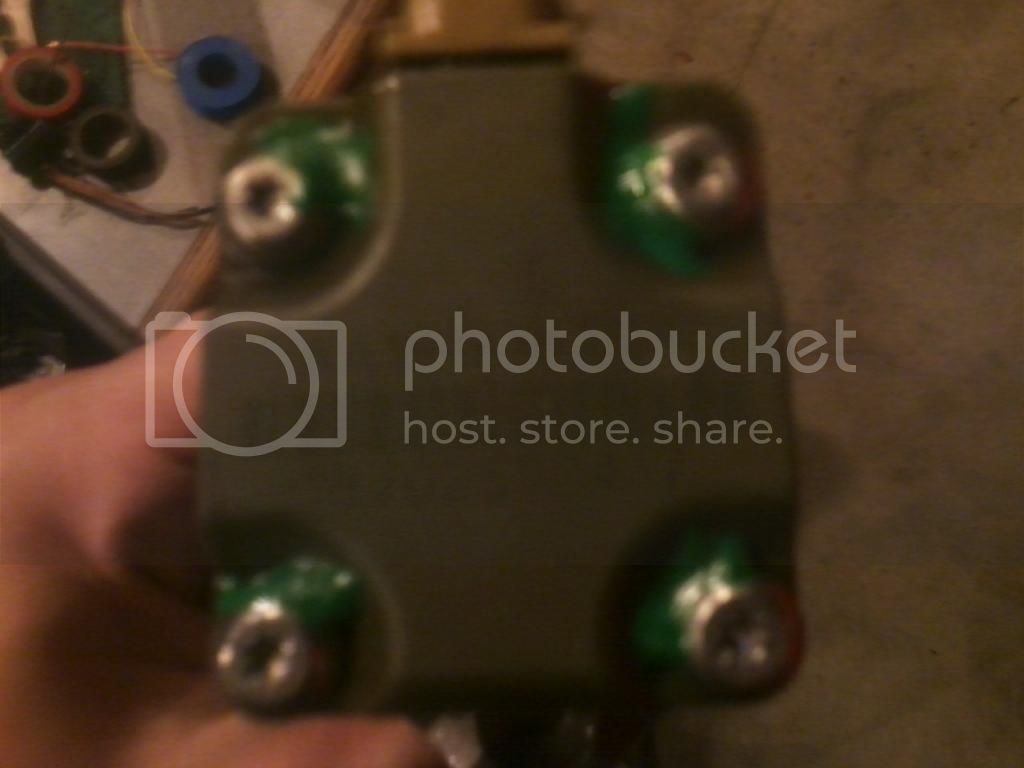

Result: two inectors with cracked solenoids
And to top it all off, it appears that they replaced the HPO side o-rings but didn't bother to replace the lower two.
The copious amounts of greed thread locking compound was an especially nice touch. No doubt to prevent me from being able to remove the solenoid and confirm that they had in fact corrected the armature clearance issues.

Thats not green loctite. thats just anti-tamper dye... You use it to make sure the customer doesn't undue the fastener. If they do then they know you were fooling around cause it breaks offs

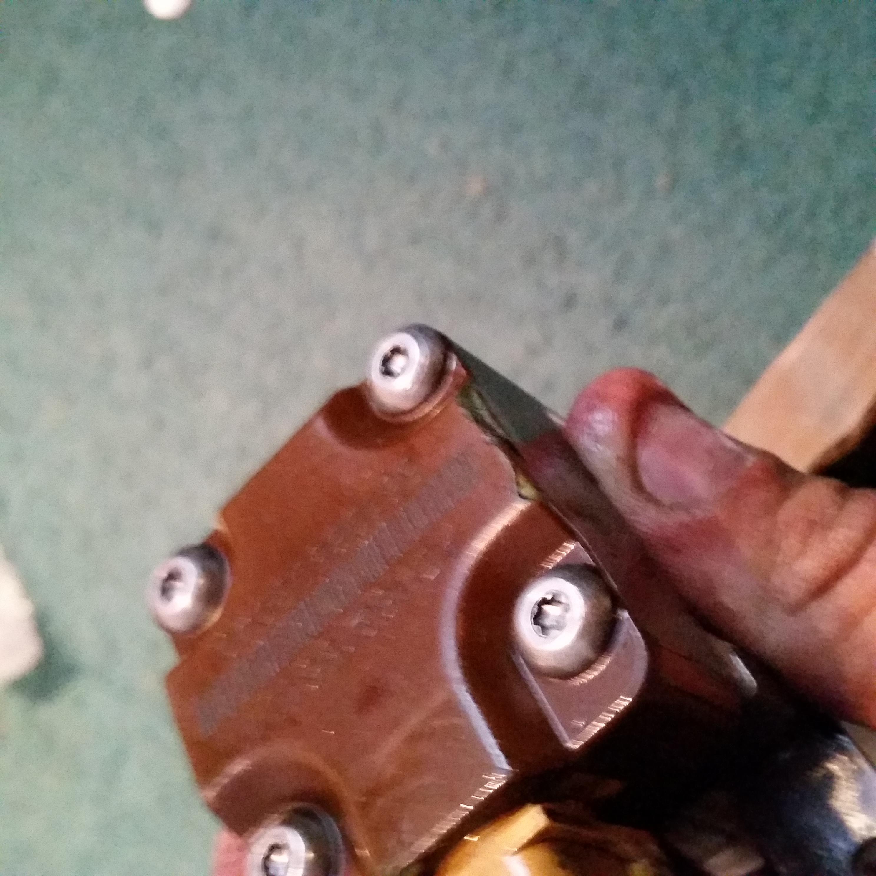

I got some from a vendor that were honestly packaged worst than that all 8 were in a 12" by 8" box with barley any bubble wrap between. Honestly I was so pissed I just threw them on the shelf now I'm wondering how many solenoids are broken I better go check....

Here are some pics I just snapped of them... seems like the solenoids were all hitting something. I attached a picture is this anything serious? Seems like all of them have it one is a little worse than this one.
So as a paying customer I have no right to remove solenoids (which are now broken) and confirm that armature clearance is within an acceptable range?
