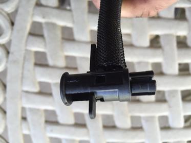

Any one have tips on how to disconnect the injector return supply lines. There seems to be 3 different tab connectors and I've only seen the one that shows to push down on the outside and pull on the middle which that has me baffled. I don't want to break anything and I want to make sure I'm doing it correctly. So any tips or videos? Especially the one with out the tabs.

The middle section will slide up. I usually grab them with a pair of pliers and gently slide it. Make sure you only grab the lip around the middle, otherwise, youre gonna be fighting yourself trying to lift it.

This will give you an idea how they slide
