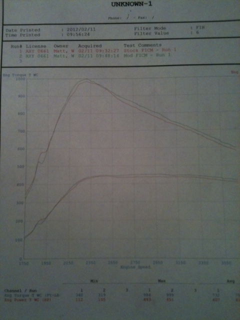

Yeah, but its a phone pic and it sucks. It's actually the stock FICM lines laid over the modded FICM lines

I just dynoed at PHP on 11 Feb, 454rwhp and 980lb/tq with an intake (aFe Stage II), exhaust (5" MBRP), tune (Matt @ Gearhead's SRL+), and a FICM tune from Bill at PHP.
