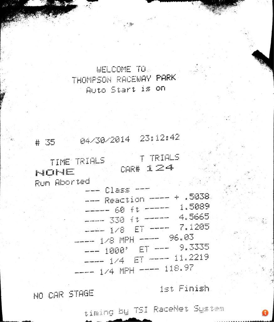

Bushwood_6.0
HELL YEA!!!
Now it's 80 time lol
HELL YEA!!!

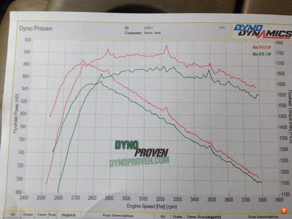

Here is a solid parts list that will get you 800+
Bullseye's s475 tct 87/80 .90ar
Our 350/100's
Our twin oil pump kit
Oliver's intake
625 studs
Push rods and valve springs
No remorse headers.
Air to water IC
IDP ficm tune
Bone stock bottom end and heads.
That's about it. We can provide the entire package right down to the tune.
All on fuel only
