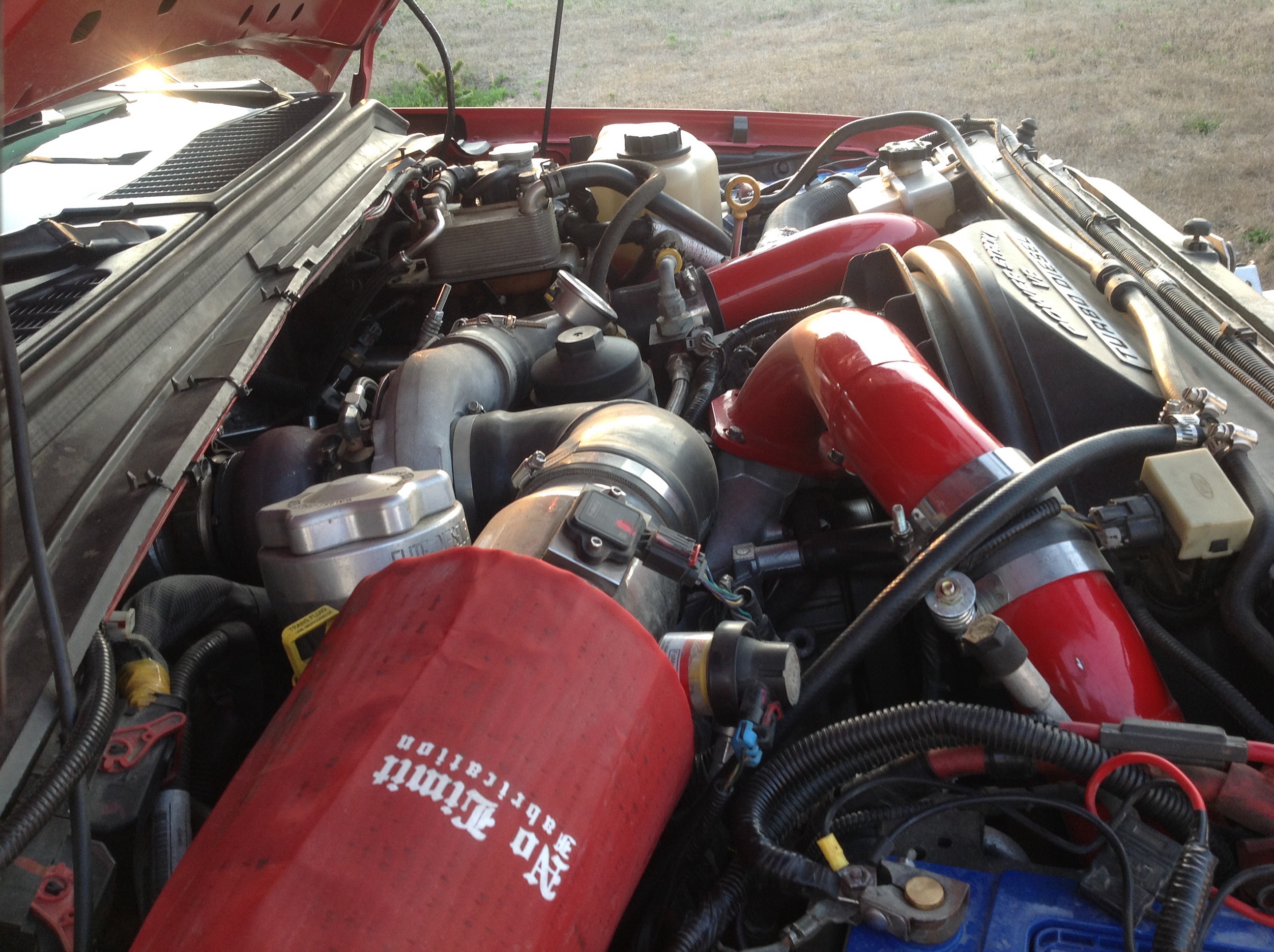

Red Ripper
Sep 19, 2012
97
Vancouver Island BC
BD manifolds & up pipes work perfect with this set up and I'm loving the sounds but it's loud!!!
