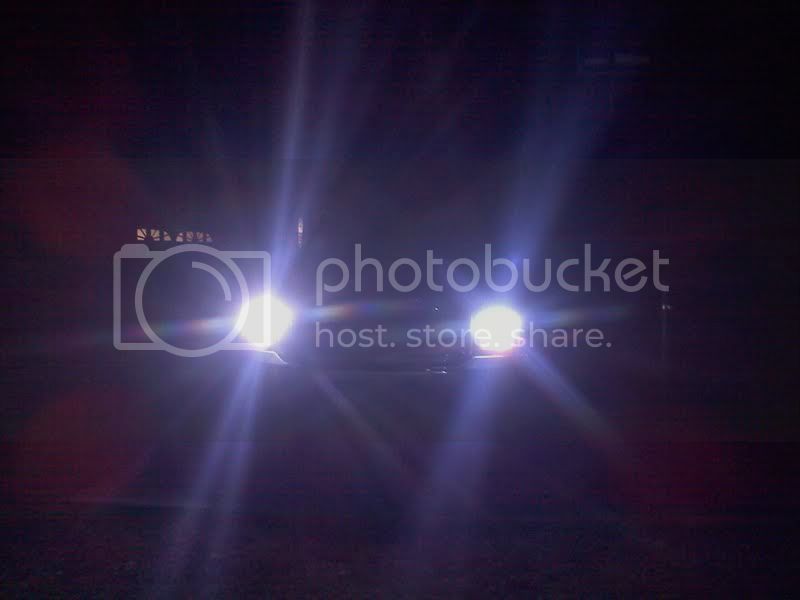

Well i came home to a nice shiney box with some goodies in it today. Ordered them monday and got here in 3 days which is pretty good. Install was a breeze, took 2 hours from start to finish. Very simple plug and play installation. Here's a crapy cell phone pic.

Looks good, thank you again for the order!

looks good
Thanks Michael
