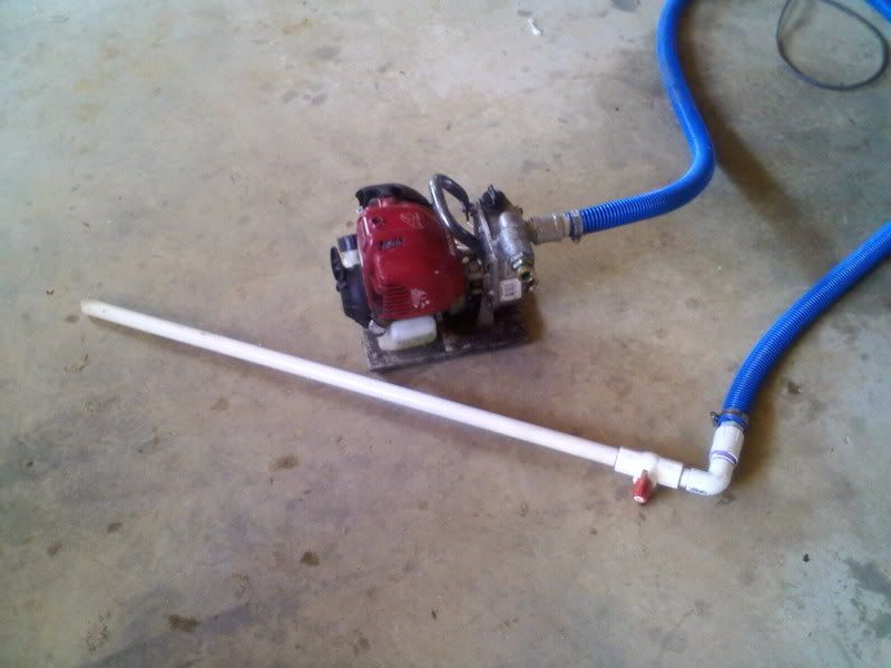

Here's my Honda:

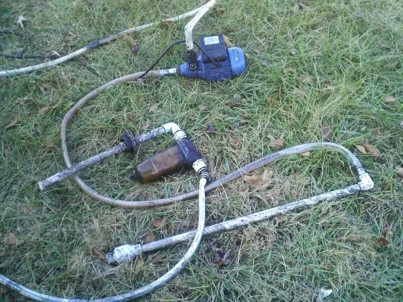

And the venerable $30 HF 'blue pump' (110v 1" Clear Water pump) - set up with filter on pressure-side:
The only problem with the 'blue pump' is it WILL NOT self-prime. If it is not plumbed in a way that maintains head pressure on the pump - you must use a check valve or something on the suction side to keep the suction hose full of oil. (see my PVC CV??) I have a friend who recently set up one of these pumps with a tee on suction inlet to pump. The vertical side of tee stick straight up and has a valve, then is necked up to like 1.5" dia PVC. Since this pump is stationary/hard-plumbed, it would be difficult to fill the suction line if he lost prime... This way, he just fills the 1.5" pvc with oil, opens valve and turns pump on. Once its 'primed', he closes valve and pumps away.
