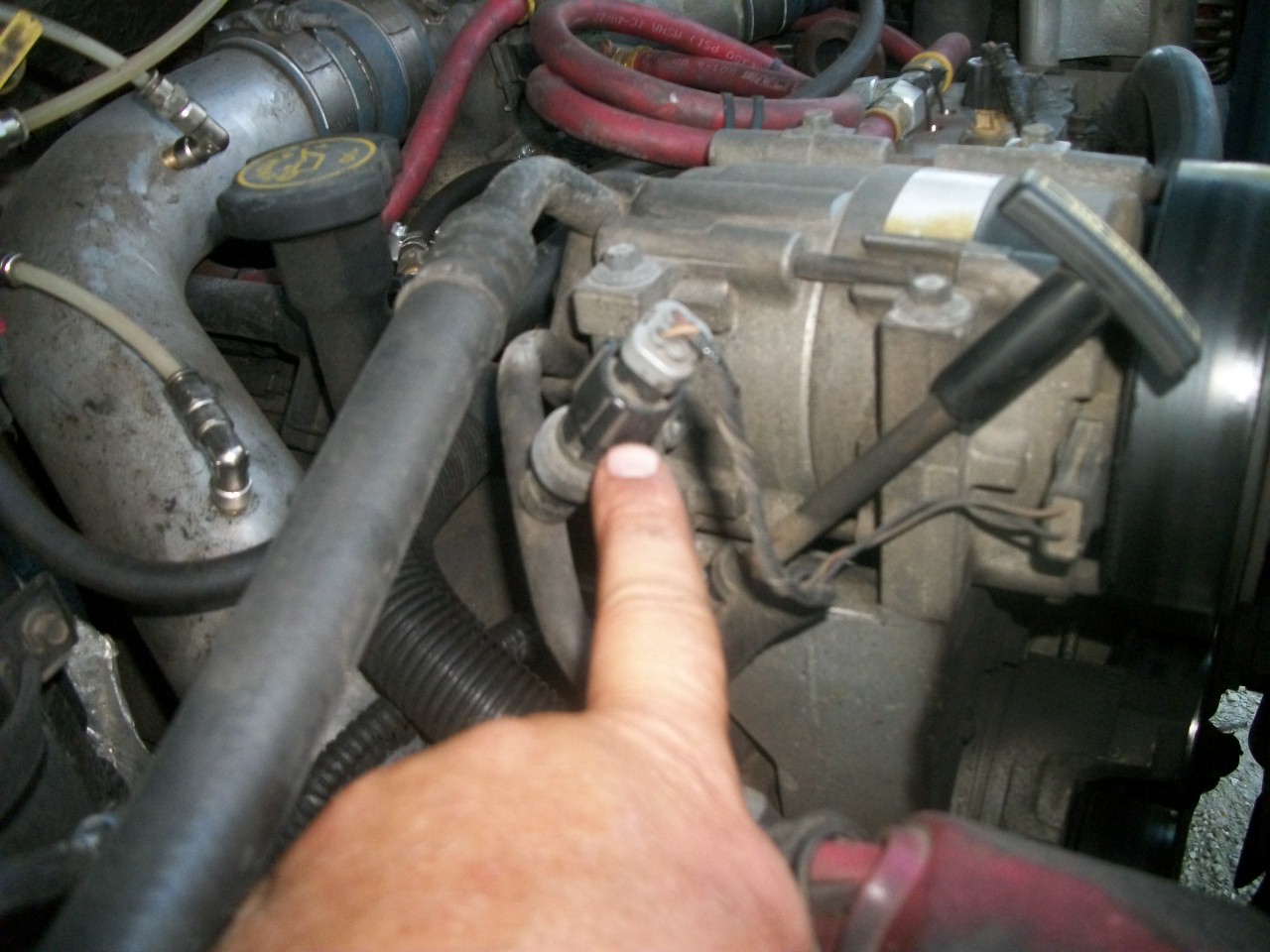

So how do you change out the lp switch, i may have to look closer at mine as i just have a simple guage.

mike, the one im pointing at is the hp switch, and the shiny one is the new lp switch. simply unplug, unscrew, screw, replug, done. :D
