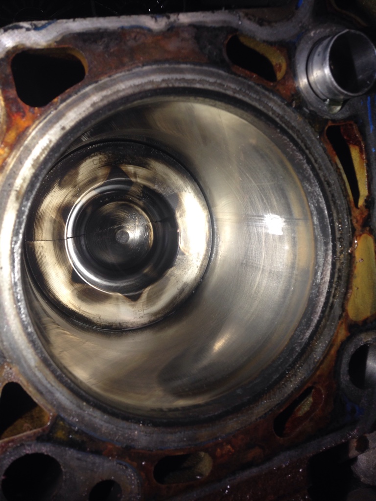

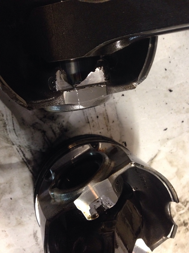

Here's a few pics I had on my phone if you want to use them. All from different trucks.

Thanks I definitely do. Look just like mine, no problem other than cracked. I'd really like to get some repair orders, estimates, or bills on anything I can, and maybe a short written statement of the name of each person and any contact info your willing to volunteer. Any one can just go out and get pictures but I need a name and a person behind them, and a bill would be a huge help that shows cracked pistons. My email is [email protected]. I am more than willing to give my cell phone as well. If I put together a case that wins, it opens the door for many others to do the same.

Not sure if the photos will attach but I'm doing typical 6.4 things this weeekend, building a new short block and swapping it out due to a cracked #2 piston. Something went threw #8 at some point as their is some witness marks in the top of the piston. Truck had a turbo failure in the last year/10k miles. Truck is a 2009 450 with 149k. Only been tuned the last year or so since turbo failures.
Aside from the chunk missing from the piston this is honestly one of the better 6.4s I've torn down at this mileage. Rocker tips still look good, no wear in the valve bridges, no hurt lifters.
Going with a ESB, 2 heads, 8 injectors and a new HPP due to getting parts cheap enough. Also using new rockers on both sides so I won't have to open it back up.
