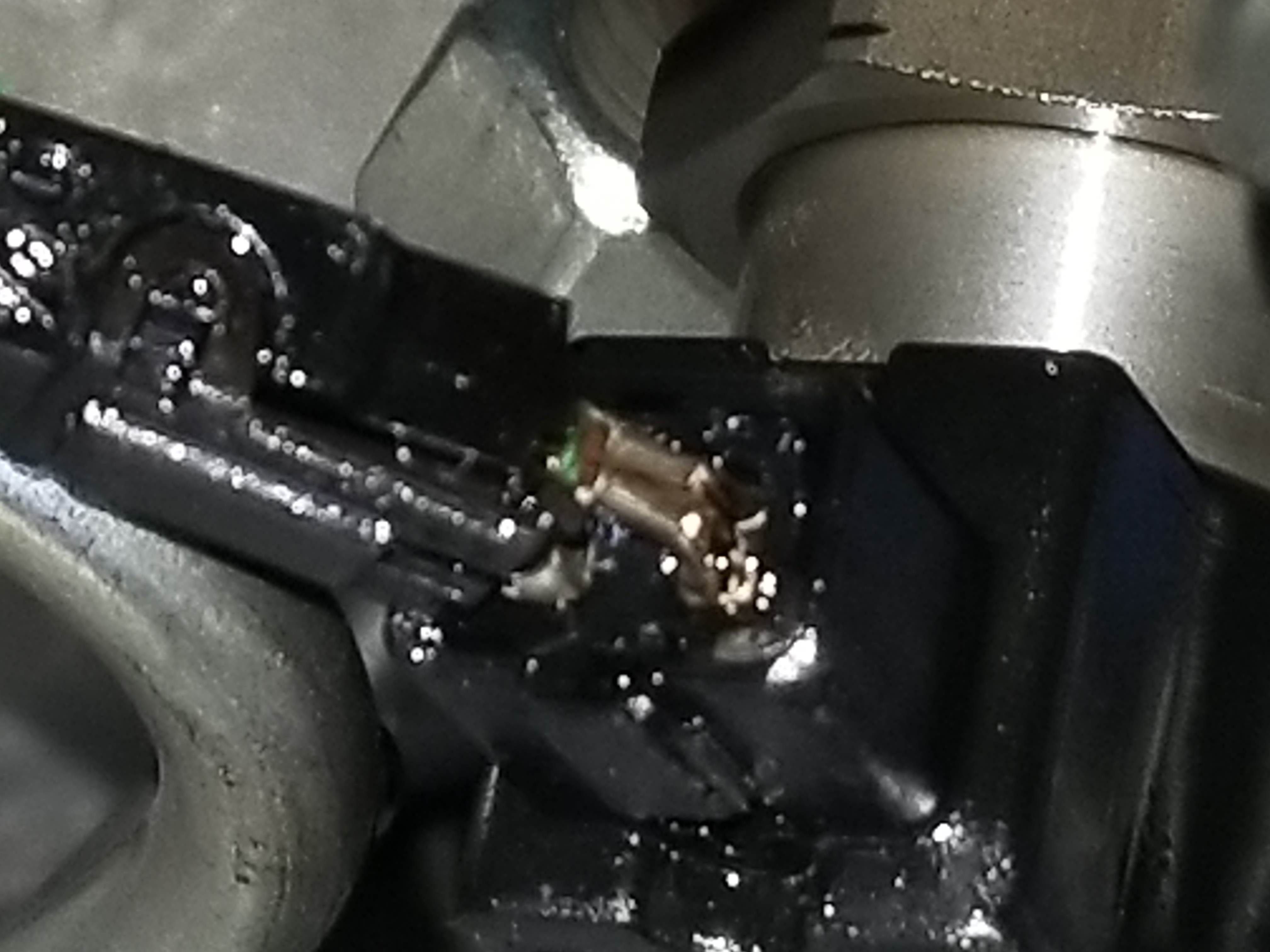

Yesterday, driving home from work I noticed the truck running a bit rough. (Out of the blue).
Got home, truck was idleing rough, and did a quick scan and got a open circuit code for #7. I think it was P0207.
I shut the truck down and restarted after a bit....truck was back to normal..no code/miss or rough idle. This morning going to work it was back ran rough had the code. Got to work shut down, can we back after a bit and restarted...no code/miss...Idled perfect. I'm guessing its injector selonoid or connection to it since it seems to be intermittent. Are the injector selonoids replaceable or would I need a new injector. I never really looked at it.
Thanks for any input.

Update...
Be careful with the valve cover..
Just wanted to close out the mystery for the next guy having issues.
