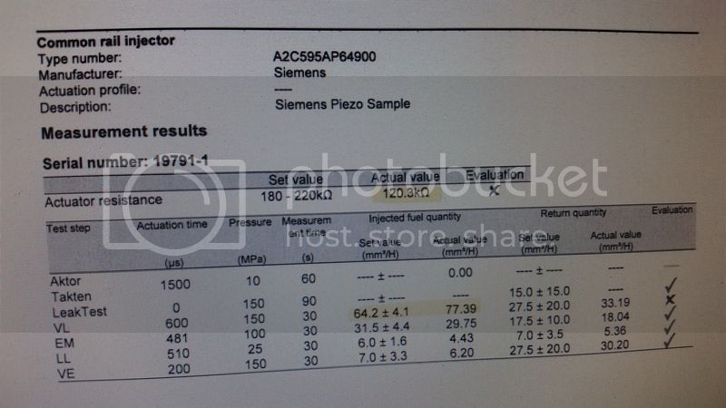

Your VL is fuel at full load, spec is 64.2 plus or minus 4.1 but your actual is 71.6 which is too high....
LL is low idle fueling, yours is too low... EM I don't remember, but i think its emissions points, we just got our bench a few months ago and have only tested a handful of these injectors...
Nashville. And we are lost. Truck ran fine when it came in. We installed 60% nozzles, and then sent them for testing and they said everyone is out of tolerance.
