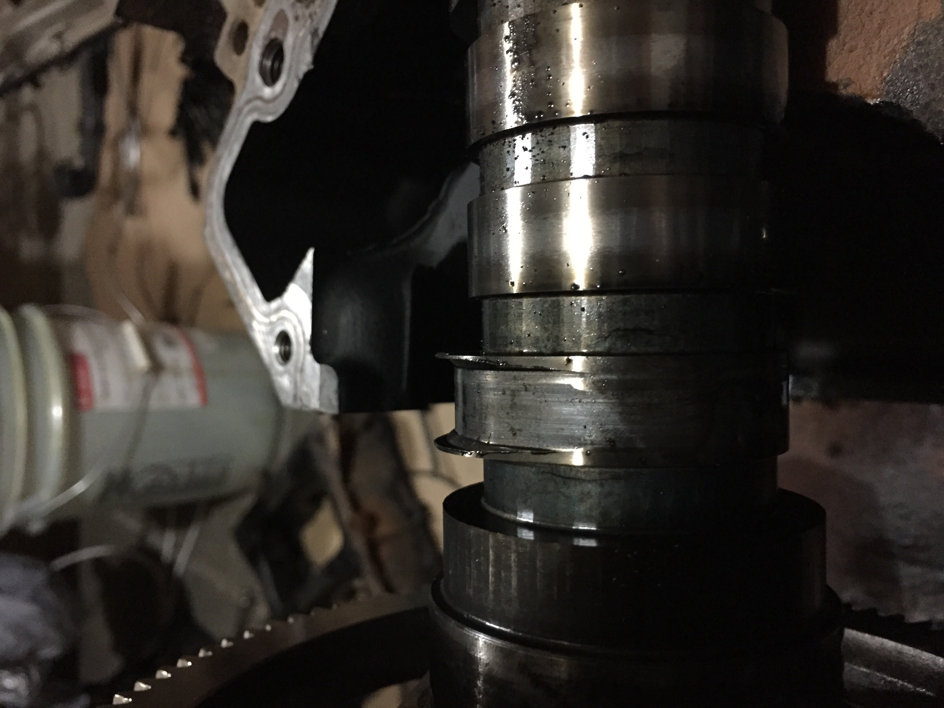

Well got the uncracked block all torn down last night everything looked good but the cam... So now I know where the metal shavings came from.

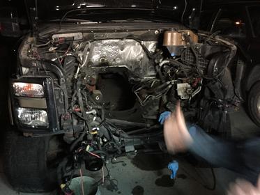

Well got the cracked block out tonight, didn't see where the crack is yet but I can see the bottom of the lifter that went democrat, it's all broken off and the roller missing.
