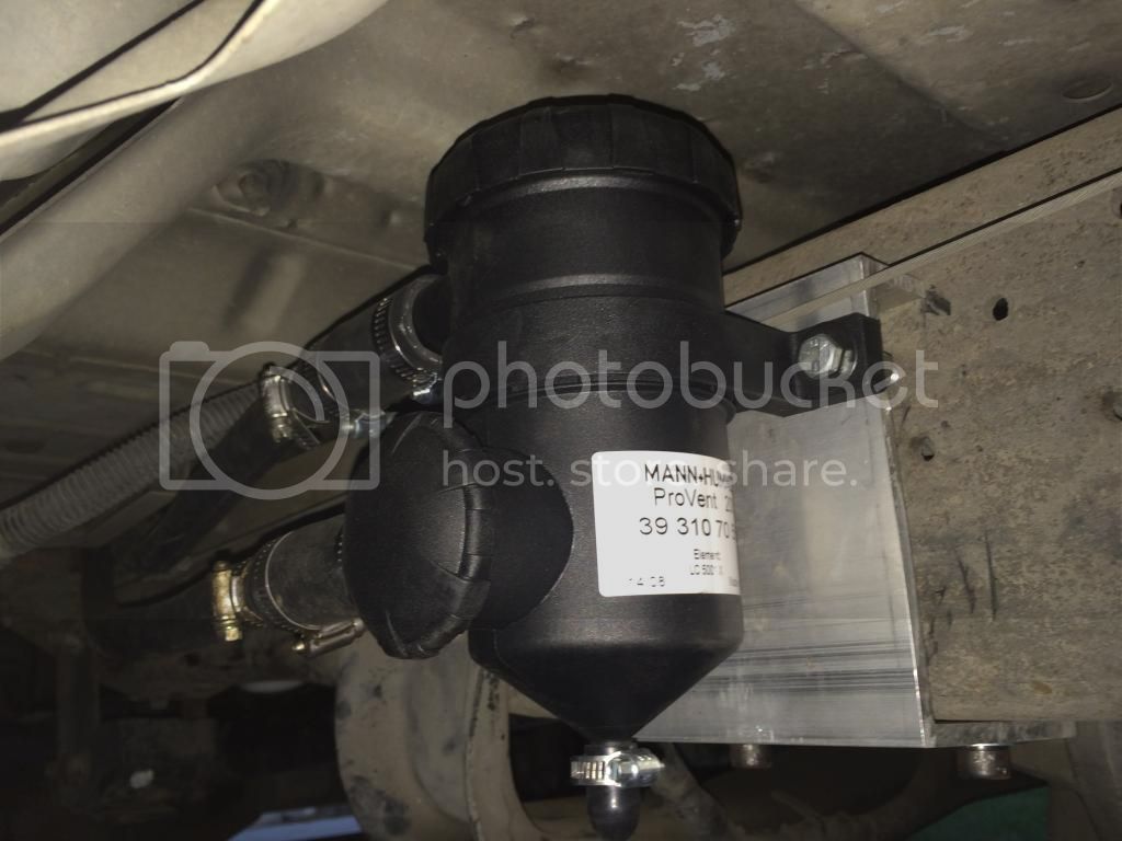

I purchased just the canister they use. It is manufactured by Mann-Hummel and the model is Provent 200. Cost was around $140 shipped. It is working great so far. Here is how I mounted it.

very cool-- I will be checking into that filter. I'm tired of the smell and Id really like to close it up.
