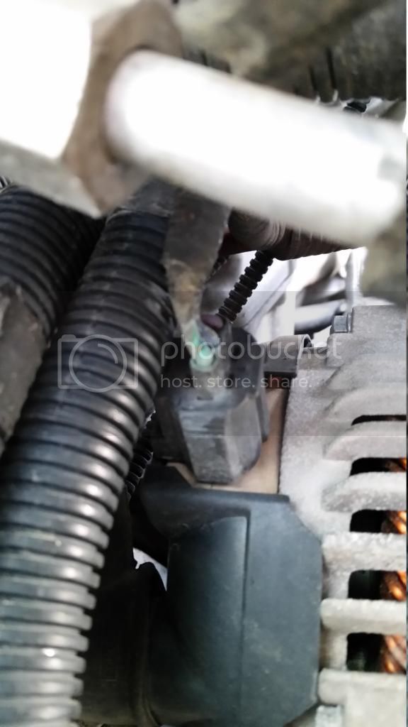

Just had the same problem not too long ago, there is a post about it on here. Check the plug on the alt. mine had a broken wire right at the plug.

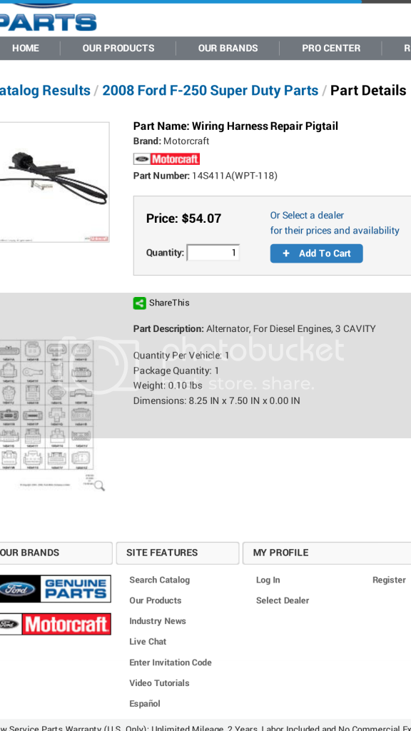

So I'm guessing this is an issue lol. I'm having a heck of a time getting that sucker unplugged though. Also what do I do to fix that
boggerr
Jun 20, 2013
243
Barnegat, N.J.
Yup, that's what mine looked like. Just get that new plug from ford and you will be set. Leave the wires a little longer when you cut them from the new plug, you can go around the one hose so it doesn't chaff again.
