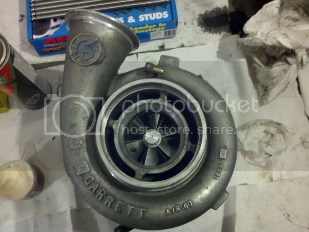

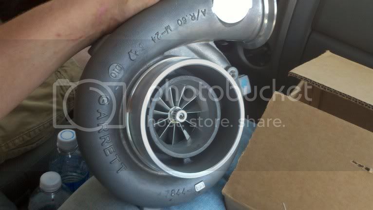

Yep. Upgraded from the junkyard gt4294 to a GTX4294! One question. Was it worth it? If anybody is interested I would be glad to share whether or not it was.
I went from....
To......
I also went from a .98 turbine housing to a 1.12 so if lag is less then that will really give a big plus to the gtx!
P.s. The difference in price is this- I have $780 (retail $1,100) in the journal bearing turbo counting the rebuild, turbine housing, new compressor wheel, and turbo itself. The GTX retails for $2,808. This thing better be awesome! LOL

vander,
Do not forget to install a plug or your fitting and boost hose into that port on the comp housing. On the new comp housing it does not come by default. I can see the open port in your pic of it right next to the blue paint dot @ about 2 oclock
