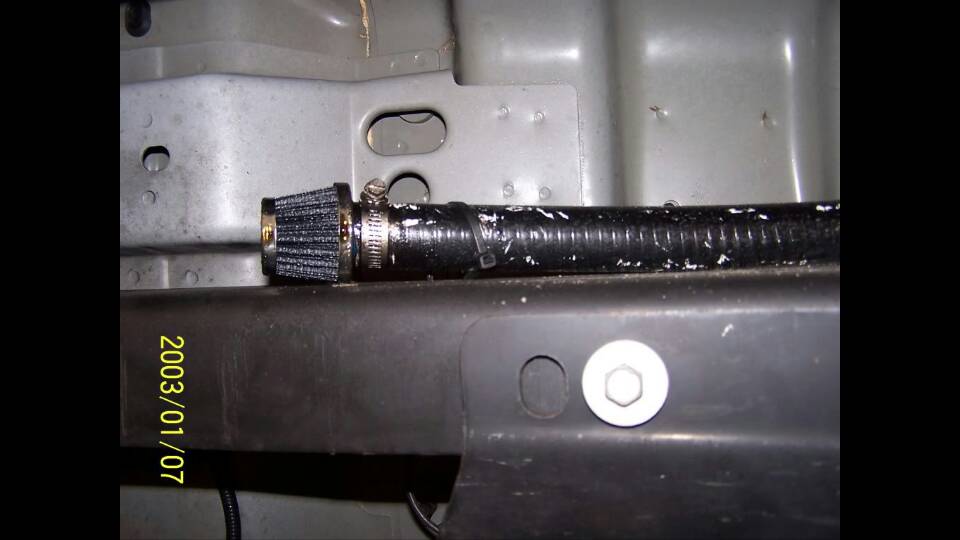

Some people dump it to the ground/frame rail. Other people get an oil catch can.
Also some aftermarket cold air intakes come with a plug for the ccv thats goes into the intake.

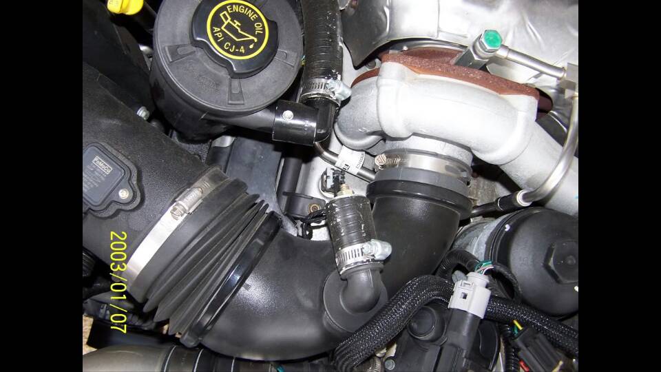

I did this, less the filter.
Sent from my SGH-I337M using Tapatalk

Its stock, unless i absolutely need an aftermarket one i don't want one... I think those k&n filters and other filters that are covered in oil don't protect the motor. I think i could get my hands on a used afe cia.
So the ccv mod wont let unmetered air into the motor?

You will be fine with stock air box than. Look at the pics in my previous post. Just copy that. Plug the ccv hole on the intake as it is sucking. Than on the oil filler neck is the vent portion. That line is always pressured as long as your engine is running. Get some hose and route it down along the frame rail.
