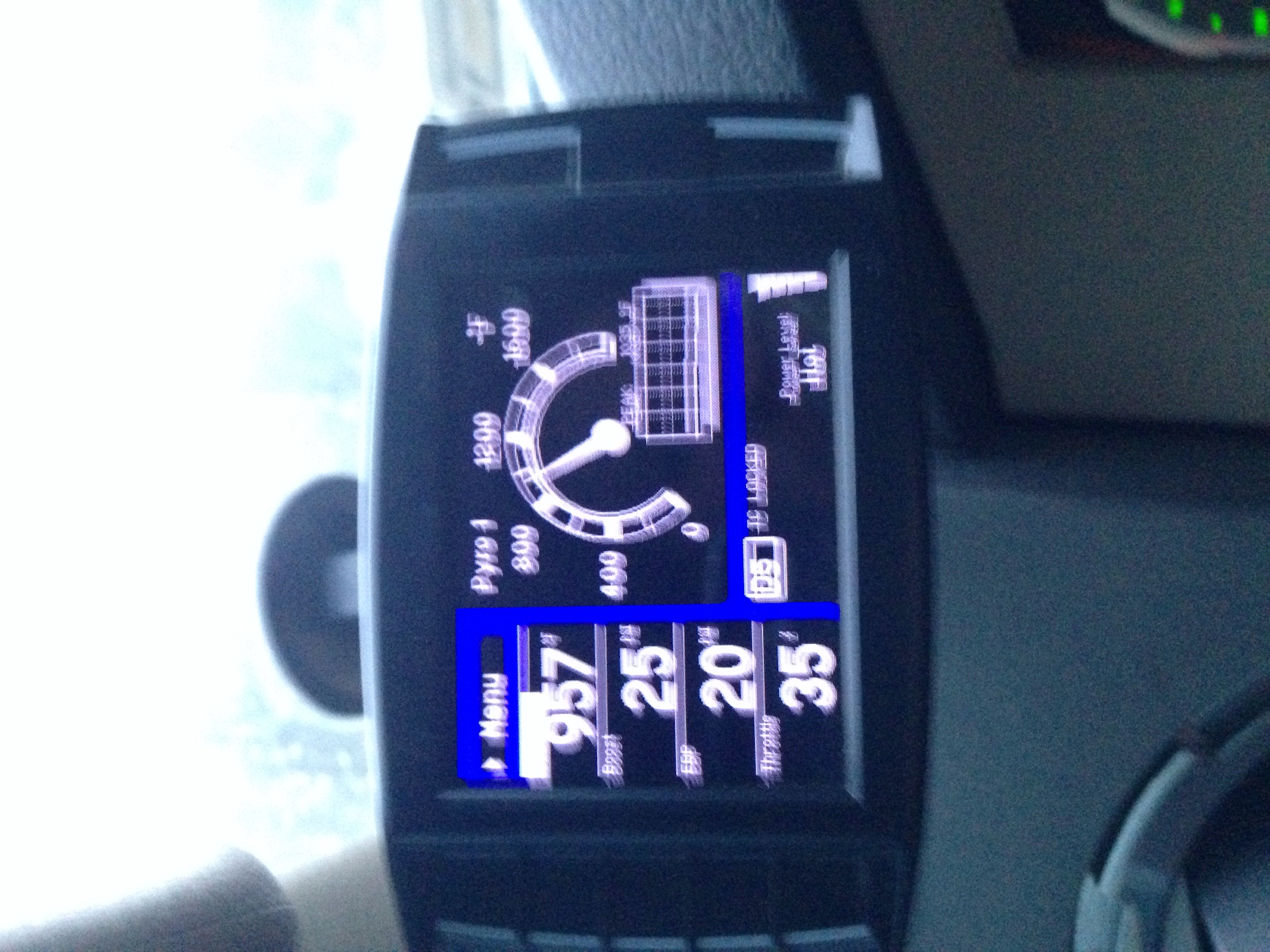

Is this an issue or not (see attachment)
Stroked777
Apr 16, 2013
3,202
Glenrock, Wyoming
On a mini max goes
EGT
boost
Ebp
Throttle %
Is this normal or do I have the most efficient stock turbo, I haven never seen the boost higher than drive pressure, or don't know if it's even possible . This was on flat ground too. Is there an issue or not? HD300 eng file with some tweaks I made to it, only tweaks are higher RP at idle and open vanes at idle
suprdzlduty
Apr 17, 2012
423
Prospect, Oh
Are the vanes open all the time? Remember that the mini max is only reading what the computer sees through the sensors...are your "tweaks" fooling the computer enough to post false numbers? That is what a tunes do...Just a thought...
suprdzlduty
Apr 17, 2012
423
Prospect, Oh
Ambient temps could be playin a role in this...the ebp on the 6.4's can be deceiving in very cold weather...I see you're in ny...lol daggon global warming...
