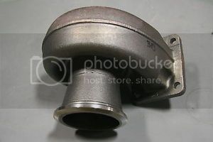

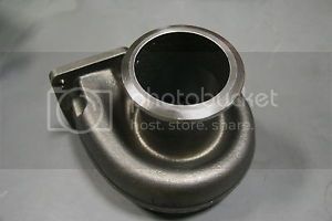

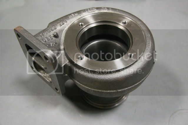

Is this the T4 .83 turbine housing everyone raves about?
MorganY
Oct 3, 2011
2,950
college station, tx
Hellen Keller sent this?
Yup, mine is just like that.

where did your housing come from if you don't mind me asking?
Jake @ Irate. Was quick and on the money.

I agree there are a LOT of different styles out there. Its hard to keep up with them all. This is a .83 A/R housing made for the 68mm turbine wheel. Its a Genuine Borg Warner housing.

Before the FMW unit, a 68 housing needed to be machined correct?
I'll have to get mine out and take a look at it, but I don't remember such a long snout on mine.

Correct. That's a 179069, comes on the 62/68 FMW

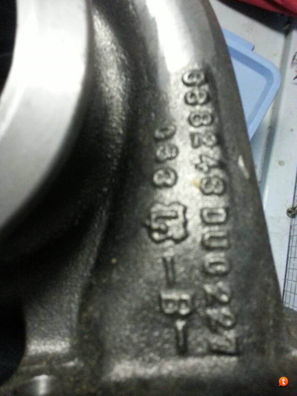

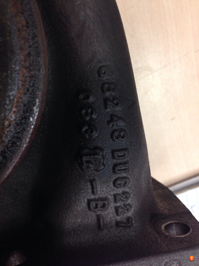

I am preety sure that is not the part number that is stamped on the housing.
I can check But almost 100% sure that is not it. The part number start with a 6 and ends with a 8 I will have to check.

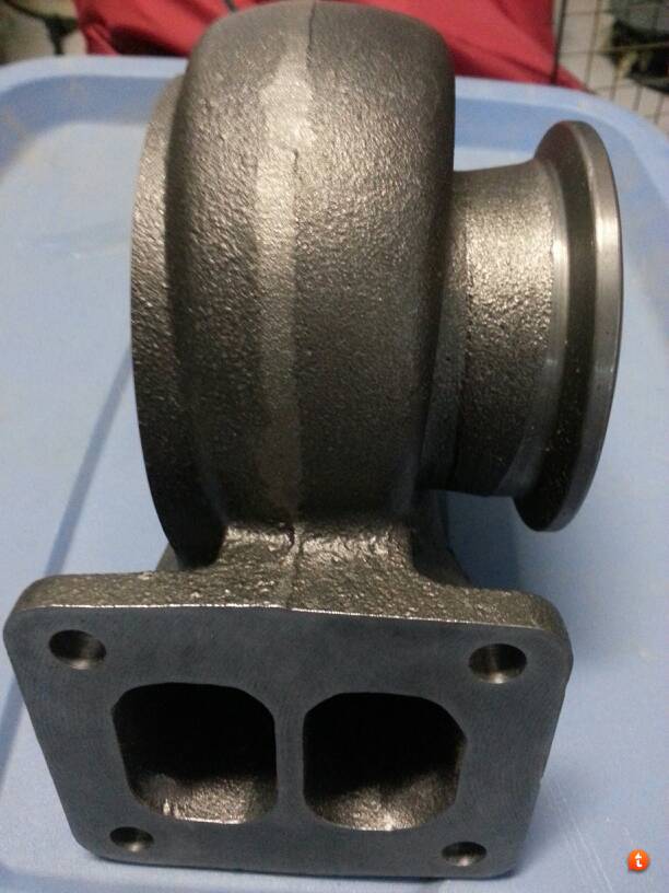

Here is a comparison between the T3 .70 housing on the right, and the T4 .83 housing on the left.
Extended Power
May 24, 2011
2,216
Yeah i definitely wouldnt put that on, not worth the time LOL
Why?
Since when can a person tell how a housing will work just by looking at it?
One is taller and longer because it has an internal gate.
The other is a straight divided housing, no extra bullschit attached.
That number on the side isn't always a part number. May just be a casting number.

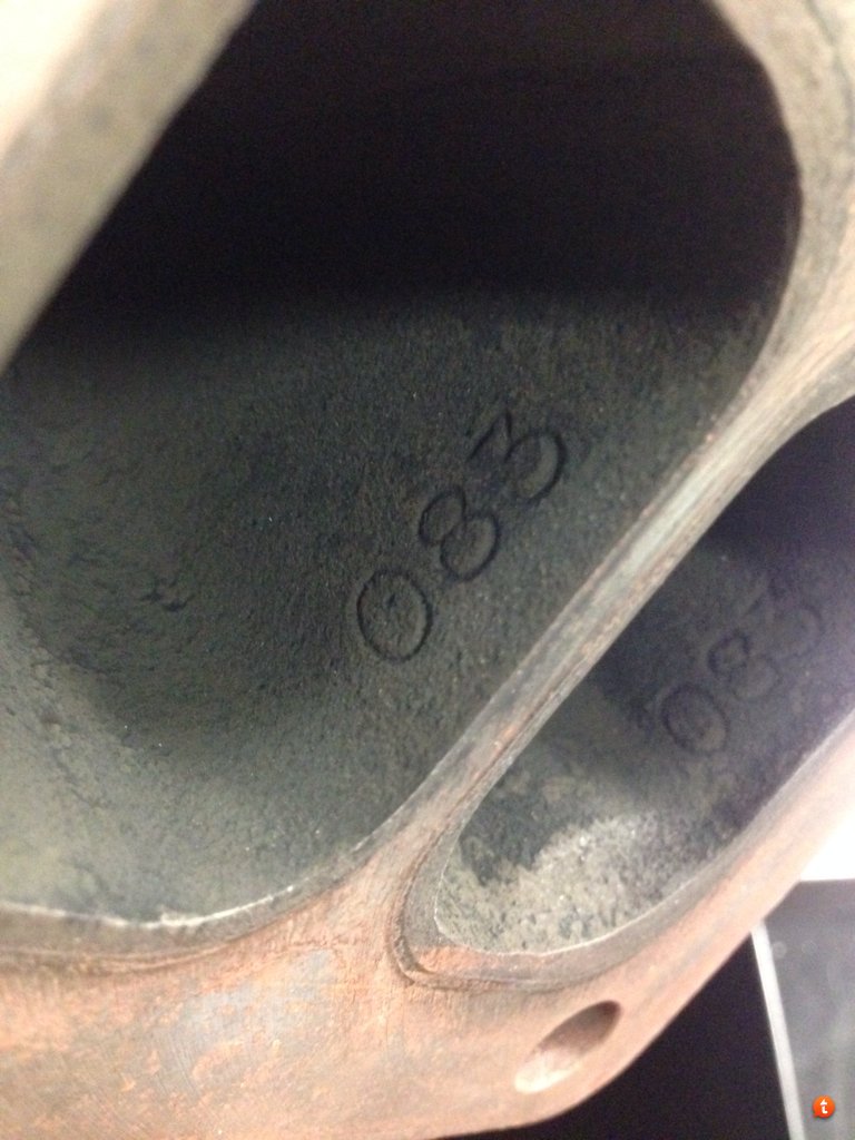

If I am not mistaken, there is a .83 T4 S200 turbine housing as well. Doesn't explain the different port size, but could explain the variance in housing look from the exterior view.
