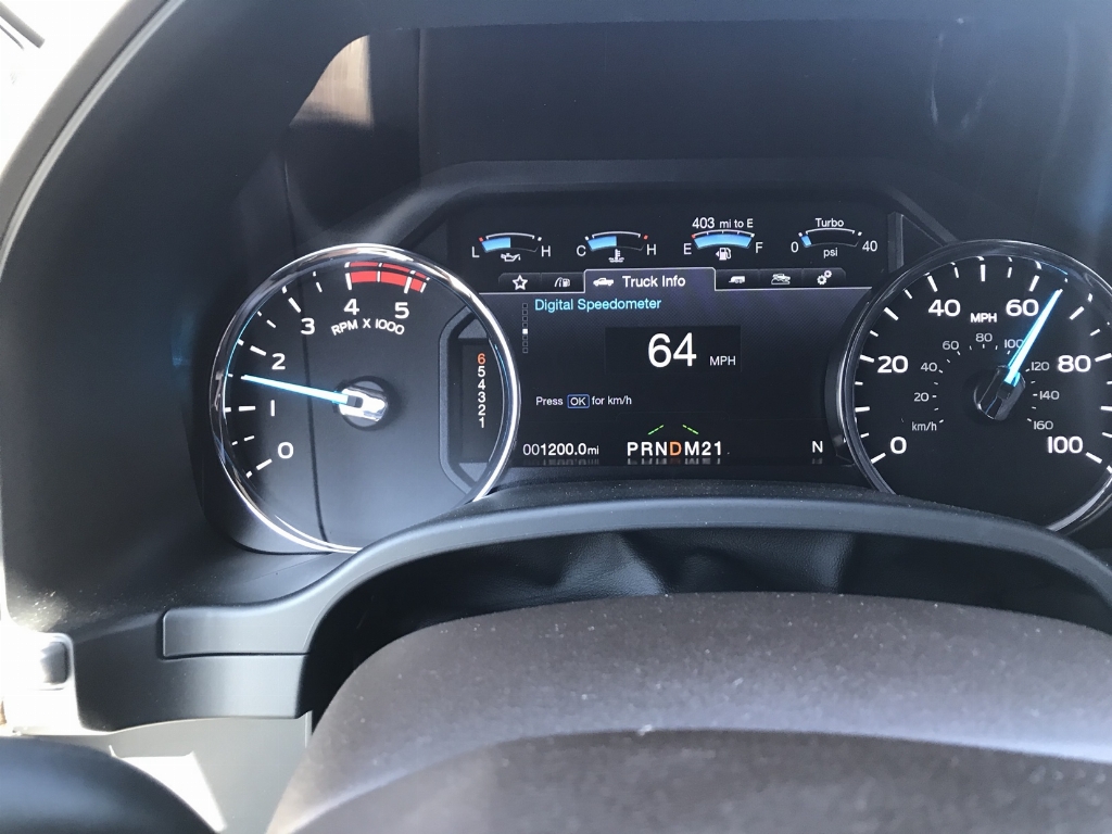

So by the looks of it. Truck won’t get lowered till next week. Work got in the way.
On a side note Truck has 1200miles already.

1400 now in 5 days. Not too bad lol. I’ll have 2500 but Sunday night.

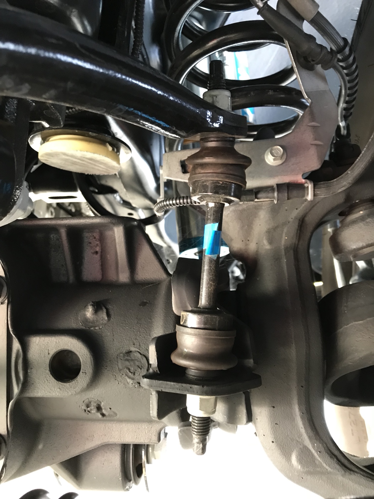

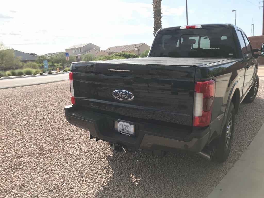

Rear end is lowered. I also started the emblem/sticker delte

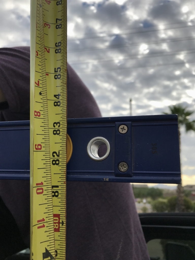

This is the cab hight I started with. 81.25in

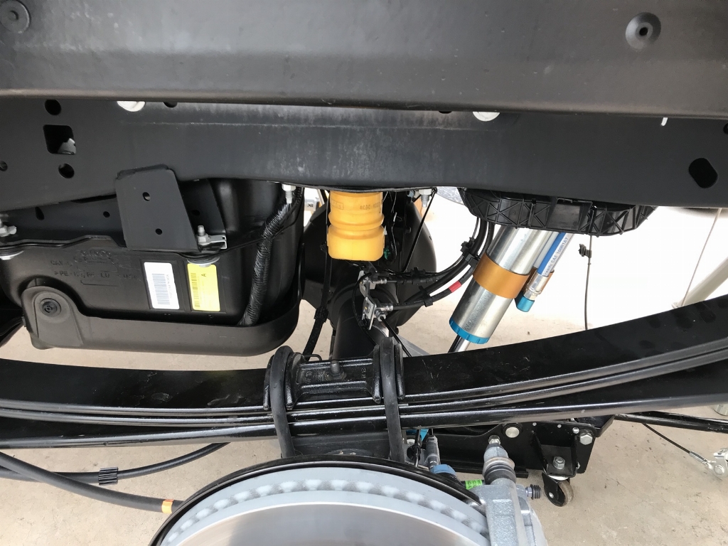

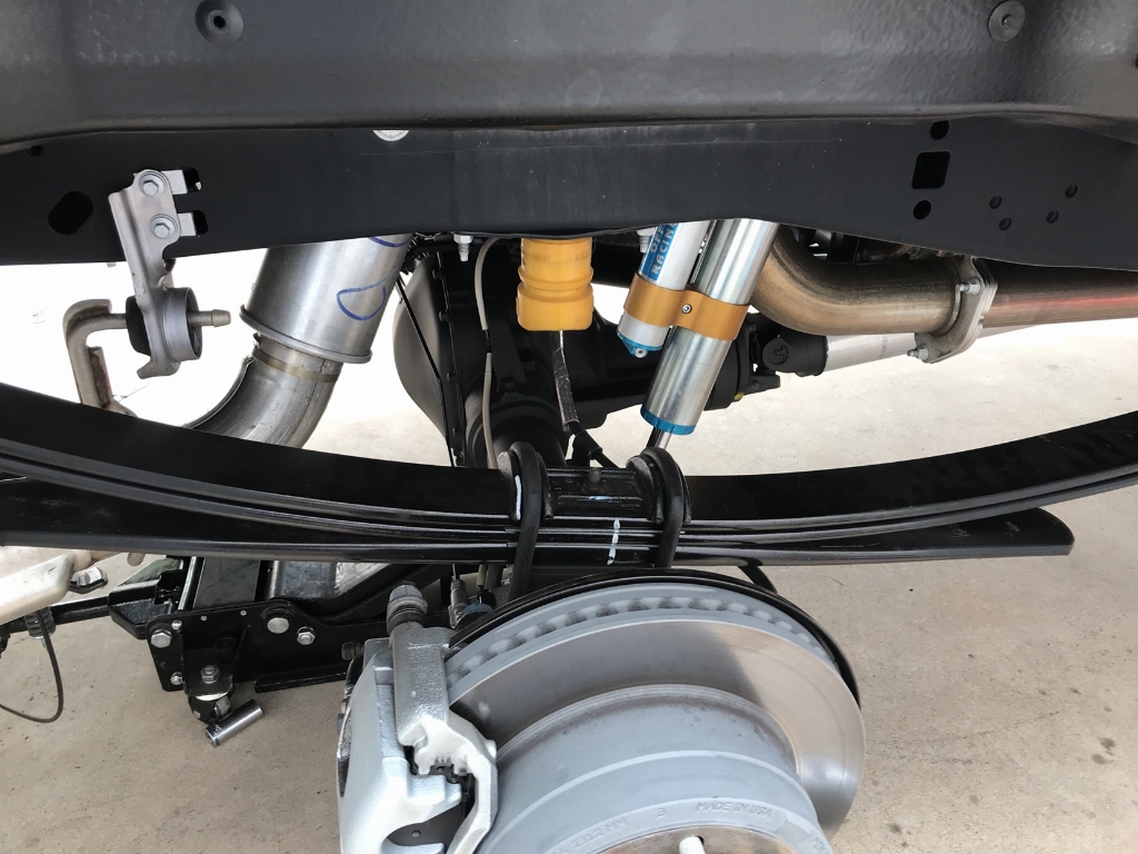

Out with the old crappy shocks. In with the new Kings.
3555fd7b62695fe7b74fbe65963381a1.heic
Ranchos were already leaking!!
f8fe87d6cd63eb39e6037c20c5ebd1ab.heic
Block ****** and Kings installed

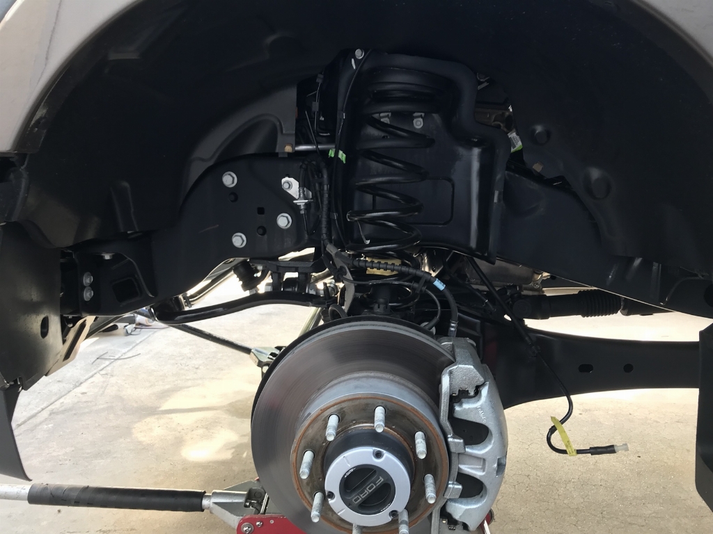

How the Truck sits with the stock front hight and the rear lowered.
King ranch emblem removed off the tail gate and the fx4 stickers removed
Starting on the front end in about an hour.

get those mudflaps off before they ruin the paint. May as well loose the powerstroke badges too now that youve started...
Connor M
Youtube Certified Master Technician
Oct 12, 2016
693
6
Masshole
Debagding is so satisfying. Favorite tool in my box is the eraser wheel :thumbsup:
Jomax
8,576
7
Arizona
Those little pos are off. They were already killing the paint.. all badges removed.

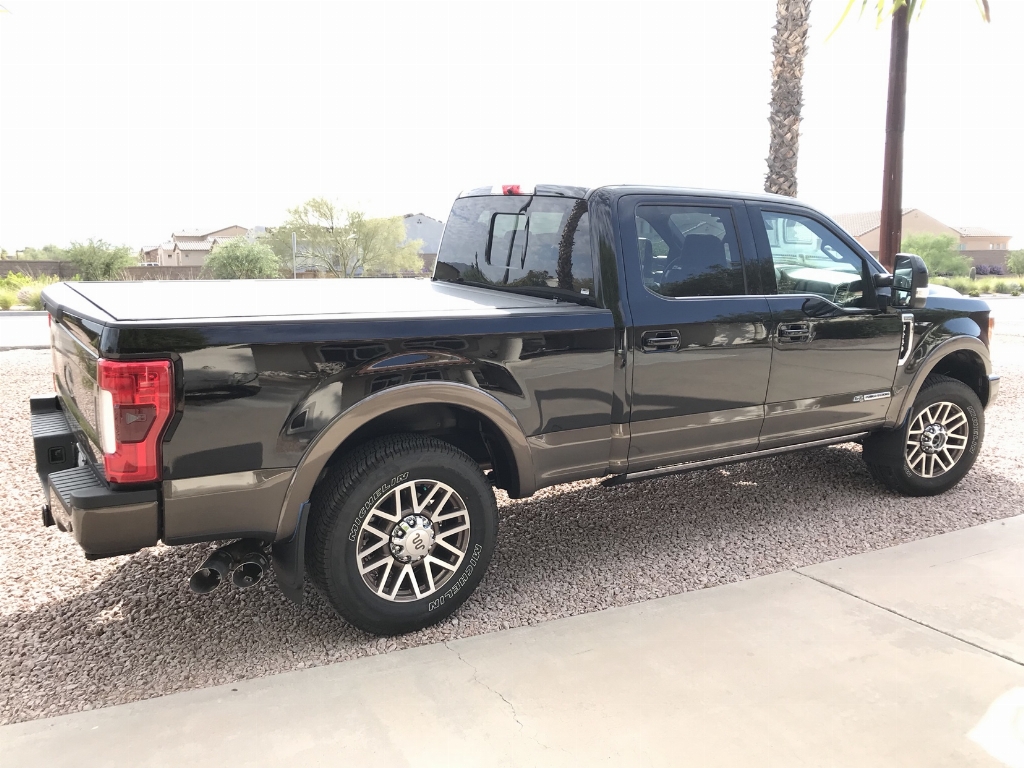

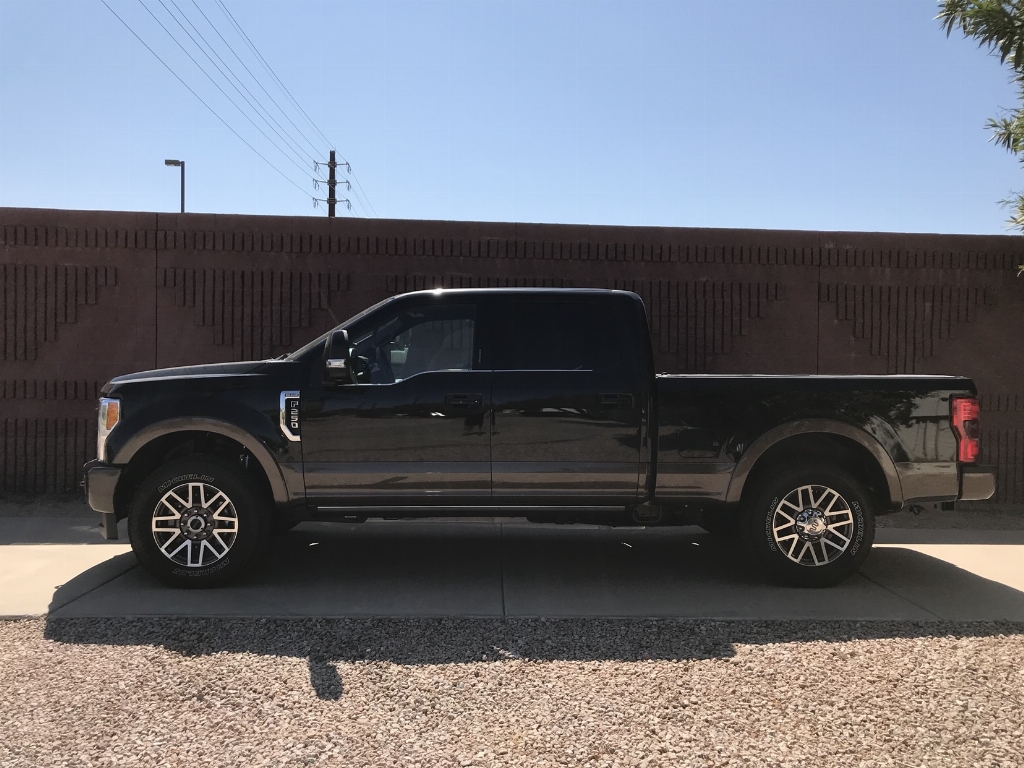

So here it is lowered..
Front dropped about 1in and rear almost three. The rear is 1-1.5in taller.
I also cycled the suspension without bumpstops with the plates hitting the axle and he axle made no contact. So I trimmed the bump stops accordingly. From the factory. The truck had 1 in of travel before it would contact the bumpstop. It now has 2in.
41cac26256603ef7ed588e50ccd5dd06.heic
179560e10ef83a834bd5fc161c973faa.heic
4400lb springs and king shocks.
03cdf4e5c4ed28acd5bc4afad607093a.heic
How it sits with 4400lb springs and rear block ******.
